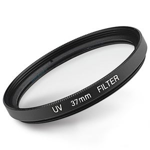

37mm uv filter

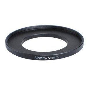

37-52mm step ring

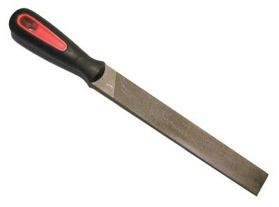

a metal file, screw driver, plier

Because of the step ring having an edge inside and not a cone shape, this is only good for 120 degree setting, and will vignette on corners.

Step 1: Remove the Glass of the 37mm Uv Filter
Using a screw driver, or a small plier (or a more proper tool), remove the glass from the 37mm uv filter. The outer ring will be glued to the case' door. The glass and the lock, will not be used

Attach all 37mm uv ring, 37-52mm step ring and 52mm uv filter (not too tight), then put it on the case door. Using a mobile phone, through PlayMemories app, check if there is vignette in 120 degree setting. If it does, we need to file the rear of 37mm ring,s o we can push back the glass and the step ring closer to the lens.
If you file too much, the 52mm uv filter glass will be too close and hit the door's glass. We dont want that.

Step 3: Glue the 37mm Uv Ring to Case' Door
Now we can glue it up. We will only glue the 37mm uv ring to the case' door. This way, the flat lens is removable.
Put the 37mm uv ring on the door, and put super glue inside the ring, between the glass and NOT ON THE GLASS. You shouldn't put too much or else the glue will block the screw thread inside the ring. And that will prevent you from screwing the 37-52mm step ring firmly. Wait for the glue to fully dry. Some white mist may appear around the glue, you can clean that with acetone. Just put a small amount on a piece cloth and wipe. Use the acetone to correct poorly applied glue.
*If you filed the rear of 37mm uv ring, you may want to cover the filed part with some kind of paint or glue, as protection. It may rust over time, especially in sea water, even aluminum. Mine is covered with a sharpie black because I forgot to cover it with glue

Step 4: Seal the 52mm Uv Filter
I also super glued the sides of the 52mm uv filter to seal it. I unscrewed the lock ring of the glass, applied glue to all sides. Then screwed the lock ring again. Waited for it to fully dry, and cleaned the flass with acetone.
If you used a multicoated uv lens, you need to use a different sealant than super glue. Because you'll damage the coat if you clean excess glue with acetone

Put teflon tape between 37-52mm ring and 52mm uv filter. The teflon tape seals it. 2 -3 layers of teflon will do.
Put teflon tape also on the 37-52mm ring.
Attach everything!
Attach everything!
