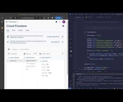

Step 3: Create Firestore Database
  1. First, search "firebase console" on your web browser, open the website backed by google then login.
  2. Then click add project, enter your project name then click continue, enable google analytics then continue, choose a default account then click continue.
  3. After you have seen the home page, go to "Authentication" on the left side then click "Get started".
  4. You will open the "Sign-in method" menu, then click "Email/password and enable "Email/password".
  5. Go to "Users" menu then Add user.
  6. Add your email and password. you need to remember the password. I suggest you to note it. Then click "Add User"
  7.  After that go to the "Firestore Database" menu on the left side, then click "Create database". Click test mode and click next.
  8. You will see the page of your firestore database. there will be collections, documents, and fields after you programmed it on Visual Studio Code.
  9. Go to project settings, you will see the information needed for this project.
For connecting the flutter to the firestore, you need to add JSON file. To get the JSON file follow the instruction below:

Step 4: ESP32 Code
  1. Open your visual studio code, and create a new project in PlatformIo with ESP32 DOIT DEVKIT as a board.
  2. Don't forget to add libraries from PlatformIo. In this project, we need 3 library which is Adafruit Neopixel from Adafruit and Firebase from mobitz.
  3. Copy the code below and paste it into your main.cpp file. Don't forget to input your Firestore Database API key, Project ID, user email, user password (you can get it in your project settings), SSID, and Password of your internet/WiFi. Then upload it.
  4. You can control the Neopixel through your Firestore Database by changing the value on the fields section
