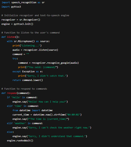

Step 1: Frame
In this first step, I started by using my Python knowledge to lay the foundation for my AI, Sophia. My main goal was to focus on voice-to-voice interaction, where she could actually listen and respond to what I say. To make that happen, I built a simple framework using if and elif statements to handle different voice inputs. This way, Sophia could recognize specific commands and give the right response. It might be basic at first, but this structure is the backbone — once it’s in place, I can keep upgrading her with more features and smarter reactions over time.
