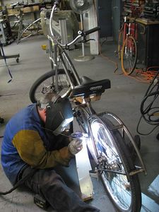

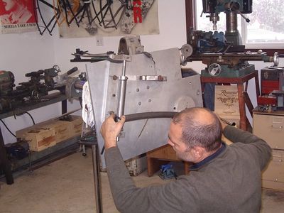

I don't know how to weld at the quality level required for bicycle frames. So I chose to work with a very skilled welder, Curtis Inglis. I chose Curtis because he already was highly familiar working with curved tubing. And his shop was in the Bay Area so I could work directly with him.
Some people would say that this isn't a DIY project because I didn't do the welding. They may be right. My friends Ross and Adam have been talking about DIT projects -- "Do It Together." DIT is more fun than DIY because you have people to keep you positive and focused.
In any case, I can't offer too much wisdom about the welding phase except to say that it will take longer than you expect to do good work on a new bicycle design.

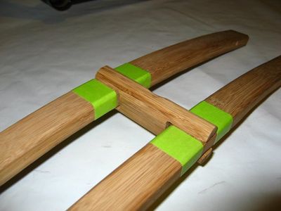

I used a bamboo lamination to create the custom seatpost assembly on the Soul Cycle Chopper. I experimented with different methods of bending the bamboo until I found a steam bending method I liked. As it turned out most of the curves I wanted to do were gentle enough to not need steam. Rather than using a steam box, I soaked the pieces of bamboo in water, then bent them around a hot pipe.
The Rock the Bike workshop is in a shared workshop community in Berkeley called the Tinker's Workshop. I raided my neighbors clamps for a few days to get the most thorough clamping job possible.

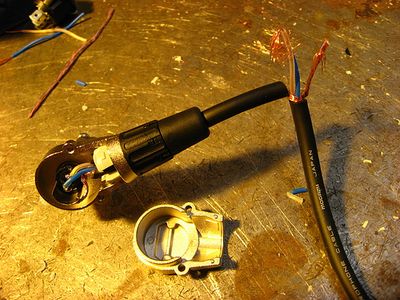

Wiring is one of the most time-consuming steps, and it really demands a lot of experience. Things that seem simple to me now, like how to use a single ground plane for your entire system, were very foreign when I wired my first soul cycle. When I wired that one, I though each circuit needed its own ground wire to the negative terminal of the battery. This means I was running many feet of wire that were redundant. Trial and error is really important to developing good practices.
The big fat connectors are 8-way connectors from Neutrik. This means that with a single twist lock motion I am connecting 8 different wires to each other, and allowing 8 different circuits to function.
Why would you want to use connectors in the first place, let alone 8-way connectors? Because, presumably, you're going to want to remove your Soul Cycle from your bike at some point (perhaps each night after you've used it). Having a quick-disconnect capability that separates the controls from the main cabinet means you won't have to be walking with one big rats nest of wires. you can undo the connectors, coil the wires and lift the cabinet off the bike for storage or service.
Same with the batteries. It's nice to be able to charge them with a quick-connect charger.
The more complicated the system you're trying to build, the more crucial it is that you start on paper. I drew several drafts of the wiring system in my notebook before moving to full sized paper.
The wiring step also encompasses coming up with elegant ways to pass the wires into the music cabinet. By this point in my project, I was getting a strong tropical fish vibe from the cabinet shape. So I decided to accentuate it by passing the wires into the cabinet near the 'mouth' of the form to give it a whisker-like appearance.

If you do go through the trouble of purchasing expensive items like wireless microphones, don't stuff them in a bag somewhere. Design your bike so you'll be able to access them while cruising / performing.
The actual backrest surface is slightly curved, for lumbar support. The acryllic reveals the circuit boards behind it for a decorative look. During a performance, I'm able to plug a guitarist into the bike, hand a wired microphone to a backup vocalist, click a track on the iPod, and lay down lyrics over it using the wireless mic . The guitarist, backup singer, and I can all set our levels using the knobs of the mixer.
On my first soul cycle I used a two channel mixer. It allowed me toperform over the iPod perform over the iPod, but I didn't have the ability to bring in other performers.
Step 22: Design and Prototype a Beefy Dual Kickstand.
If you really want to rock a party on a Soul Cycle, you need a solid kickstand. I put many hundreds of hours into my bike, and I didn't want some drunk guy knocking it over. Not to mention the fact that I will be integrating a drum machine into the performance system, and need a flat surface to mount it on. The dual kickstand takes lots of engineering, but it's worth it for things like Human Power and bike-based performance.
Of course, it would be easier if I only wanted the kickstand to function as a kickstand. But of course I wanted it to function as a passenger footrest also. This is especially challenging because it has to have both a locking 'up' position and a 'down' kickstand position.
Here are some of the prototyping stages that led to the current aluminum, water cut design.
Step 23: Build Center Kickstand
I used flat aluminum plates and bamboo laminated sides to create a box structure kickstand. I used a stainless steel strut that pivots off the rear dropout to triangulate the kickstand.
