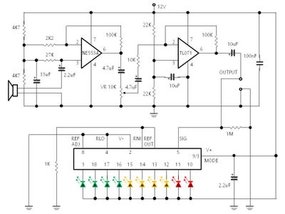

Step 1: Schematics
This sound level meter (SLM from hereinafter) combines the pre-amplifier and LM3915 circuits I found on the Internet.
The pre-amplifier circuit is posted on the following webpage.
https://www.homemade-circuits.com/op-amp-preamplifier-circuits-for-mics-guitars-pick-ups-as-buffer/
This pre-amplifier circuit can produce RMS 1V output which becomes an adequate signal level to drive the LM3915 display IC.
I had tried many other preamplifier circuits made with diverse transistors and op-amps (NE5532, LM358, TL062/TL082, and so on).
But only the above circuit can produce an adequate signal level for driving LM3915.

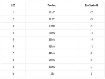

Anyway, the picture shown in the middle above describes threshold voltage levels that are driving 10 LED output pins of LM3915 IC.
The LM3915 circuit part in the schematics above is extracted from the application note of this chip.
In the chip manufacturer’s applicant note, the above circuit is introduced as a vibration sensor device that displays vibration strength with 10 LEDs.
When noise (or vibration) is applied to a sensor, each LED is turned on from a certain signal voltage level. (threshold voltage)
With the SLM device, the audio signal is input to the SIG pin (5) of LM3915 in the following manner.
LED1 turned on when input voltage is higher than (>) 60mV, LED2 > 80mV … LED9 > 890mV, LED10 > 1.25V
As the selected pre-amplifier circuit’s output voltage levels are exactly matched with the above threshold voltage levels of the LM3915 circuit, both circuits can be integrated for making SLM.

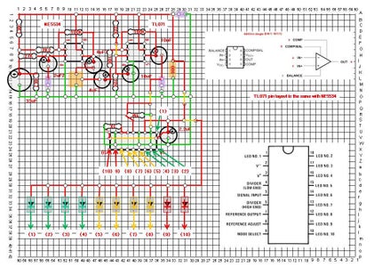

Step 3: Wiring and Soldering
When all necessary parts are prepared, SLM making can be started such as positioning the parts on the PCB, wiring, and soldering of parts as shown in the picture above.
For working on a pre-amplifier circuit, a potentiometer type of 10K VR (Variable Resistor) is preferred over a surface mounting VR type.
According to the input signal strength of Mic, the amplification rate of the pre-amplifier should be adjusted by the 10K VR.
This means the 10K VR value should be adjusted for properly activating 10 LEDs.
If you using a potentiometer type VR, (which has a knob) changing the pre-amplifier setting is easier and more convenient.
When an audio source volume level is high (such as a very noisy hip-pop music video is playing), increasing the 10K VR resistor value (such as 5K ~ 7K) can support the more dynamic visual effect of 10 LEDs.
A reversely low sound level of contents (such as documentary and news broadcasting) requires decreasing 10K VR resistance value (such as 1K~5K range) enabling more dynamic LED blinking.
The LM3915 chip and other parts can be wired and soldered as shown in the diagram above for making a display board with 10 LEDs.
For supporting personalized visual effects with 10 LEDs, you can choose a bar or dot-type display pattern.
As I prefer a bar-type display, Pin 9 of LM3915 (MODE) is wiring to the Vcc (12V).
When every part is soldered and wired together, the sound level meter is ready to operate.
