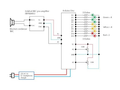

Step 1: Schematics
When you looked at the schematics of previous SLM circuits, the following analogy can be helpful to understand new schematics.
Actually, the Adafruit MAX4466 MIC-Amp board is the same as the pre-amplifier circuit.
It captures audio signals from the MIC and magnifies signal voltage with the MAX4466 amplifier IC chip.
Also, the Arduino Uno board supports LED display functionality which is covered by LM3915 IC with the previous SLM.
According to the captured audio signal voltage, certain LEDs are turned on by the sketch program stored on the Arduino board.
As input signal processing and LED blinking output is controlled by the sketch program, more custom-made SLM circuit can be made.
I'll show more details of the sketch program in the other step below.
The two 100K potentiometer's functionality can be cleared when explaining the sketch program later.

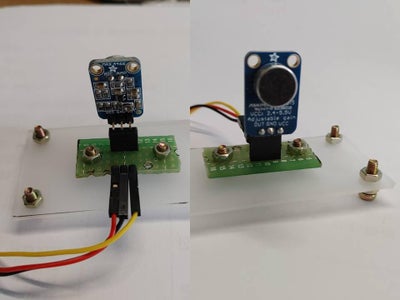

Therefore, I’m plugging this board into the small PCB and locating it right in front of the speaker.

For making a prototype Arduino-based SLM, everything is packed together into (10cm width x 15cm length) acrylic board.
A female/male pin headers are used for mounting Adafruit MIC-Amp board on acrylic board.
Different from previous SLMs, this new one requires a digital signal processing function for the analog audio signal captured by the MAX4466 IC chip.
Although the MIC integrated into the Adafruit board support a powerful omnidirectional sound capturing feature, clear and strong audio signal input is necessary to support digital signal processing by the sketch program.
Therefore, the MIC should be located right in front of the speaker.

Total 10EA LEDs are connected directly to the Arduino Uno digital ports. (D2 ~ D11)
As each digital port supplies 5V output, a current limiting resistor (330ohm) is inserted between LED and the Arduino digital port.

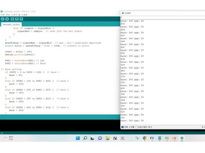

The sketch program converts the input signal into the audio voltage value (0.0~4.99V) via the A1 analog port of the Arduino.
As the power supply voltage of the MAX4466 board is 5V, the output voltage can’t be higher than 5V.
As the MAX4466 board has a small voltage level adjusting VR, I fixed the VR value to the maximum range. (After setting the VR value, it should not be changed to fix the operational scheme of the MAX4466 board)
When locating the MAX4466 board right in front of a speaker, the narrow scale (0.0~4.99V) voltage level can be captured.
Subsequently, the small input voltage converted into audio signal level value (Multiplying 100 to the input voltage) becomes 32 ~ 499 (0.03 ~ 4.99V) as shown in the graph above.
These audio signal level values can be captured to a text file by executing the following command on Windows command prompt mode.
C:\ copy COM7 audio_input.txt
The above command is assuming the Arduino Uno board is connected to the COM7 serial port.
While running the command above, the Serial Monitor of Arduino IDE should be turned off. (Arduino serial monitor takes hold of COM port and other processes can’t access the COM port)

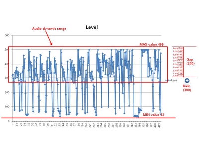

The audio signal voltages captured above are from typical content (Movie and commentary pop-cast programs) that I’m frequently viewing on YouTube.
From the graph above, the region enclosed by the red box is the most dynamic audio signal changing range.
It started from the base value of about 300 (0.3V) and a range (Gap) of 200.
When you divide 200 of gap range into 10 levels, all dynamic audio signal change regions (300~499) can be captured by 10 LEDs into 10 different signal levels like below.
Audio signal level 300~320 -> LED 1 (Green) turned on
320~340 -> LED 2 (Green) turned on
340~360 -> LED 3 (Green) turned on
360~380 -> LED 4 (Green) turned on
380~400 -> LED 5 (Yellow) turned on
400~420 -> LED 6 (Yellow) turned on
420~440 -> LED 7 (Yellow) turned on
440~460 -> LED 8 (Yellow) turned on
460~480 -> LED 9 (Red) turned on
480~500 -> LED 10 (Red) turned on
If you choose base as 100 in the graph above, the gap will become 100~300 range. (Audio signal change dynamics become flattened)
Then all the 10 LEDs are suddenly turned on at the same time or off together. (Signal pattern becomes less dynamic)
When more noise content is played (such as hip-hop songs), the base value will be increased by more than 300.
Then slightly higher base value (more than 300) capturing will be necessary.

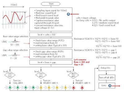

For explaining the operation logic simplified flow chart is shown.
The audio signal receiving part is from the Adafruit reference program code.
The Adafruit code segment detects resistance change of the A1 analog port and converts peak-to-peak input value into input voltage. (0~4.99V)
According to the input voltage, the sound level value (level = volts * 100) is calculated.
Subsequently, the base and gap value is read from A2, and A3 ports to be summed to level.
As Serial.print() commands are inserted into the sketch program, values of the important variables (level, base, and gap) are printed on the serial monitor window as shown in the picture above.
According to the present setting, the base is fixed at 300 and the gap is 25 by two potentiometers.
Let’s assume the gap value is 20 for simplifying the overall explanation.
The 10 LEDs are indexed as 2, 3, 4, 5, 6, 7, 8, 9, 10, 11 according to the hardwired digital port.
Therefore, the following LED lighting pattern is supported according to the input signal.
Let’s assume input voltage 3.1 (3.1V) ~ 4.65 (4.65V) during 300ms
Then levels are changed from 310 to 465.
Let’s assume VR2 (base) is 300 and VR1 (gap) is 20
During the 0~150ms time range, the following test command becomes true.
If (level > base(300) && level < base(300) + gap(20)*1) {
         pins = 2;
Subsequently, only LED 1 is turned on according to the following codes
For(int i=2;i<pins+1;i++) {
         digitalWrite(i, HIGH);
Then wait for 50ms by delay(50) to briefly show the present sound level.
Then turn off all LEDs.
