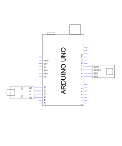

Basically you plonk a mic module into pins A0-A3 and a RGB LED module into pins 8-11 (see diagram) then you upload one of the programs below that do the following
