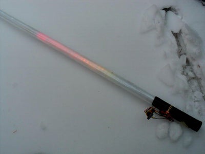

So I had the remnants from my Star Wars Neopixel Crossguard Lightsaber laying around. Sure, I could have pieced that back together for a regular lightsaber but surely there was something else to transform it into.
It contained an Adafruit Neopixel strip of 60 Neopixels. It was controlled by an Adafruit ATtiny85 based Trinket
Step 2: A Little Trinket...
You can go on Adafruit's Learning System to follow the tutorial for the Trinket Sound Reactive LED Color Organ.
This uses Adafruit's microphone module to trigger the lights. The Trinket translates the loudness of the sound into ranges of color displayed with the Neopixels.
We just need to modify the code a bit to take account of more Neopixels used and comment out the potentiometer variable since we want full brightness. There needs to be some adjustment for the noise level present in the electronics and circuitry.
I reused the same breakout board I had made for my Star Trek Enterprise Turbolift light. When connected to USB power instead of batteries, the lights are a bit brighter. This would work well with a lithium polymer battery pack.
The circuitry and battery pack can be fitted inside the tube but I left it outside so it would be easier to reprogram and change the batteries. Tape up and seal the ends to keep moisture out.
Step 3: May the Flora Be With You...
The Trinket LED Color Organ code was derived from sound reactive projects using a different microcontroller such as the Adafruit Flora which is more a full Arduino. Since the ATtiny85 chip is smaller, the response is also different so I had to really experiment with adjusting the noise level filter variable in the code. The light level should really fall back or start at lights off. In the video you can see I only got it to move a bit with it's constant high range.
