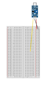

Step 1: Connecting the Sensor
Make the following connections for your sensor pins, using male-female jumper wires:
VCC pin --Connect the pin to the positive rail
Ground pin -- connect this to the negative rail.
Output pin-- connect to any of the row pins on the breadboard. In the next step, we will connect this pin to our LEDs, the 'output' of our circuit.

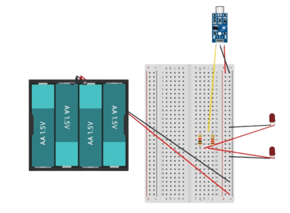

Step 2: Connecting LEDs
On the same row as the output pin of the sensor, connect two 120 ohm resistors. Then, using the male-female jumper wires, connect the LEDs to the other end of the resistor.
Connect the negative and positive rails to the negative and positive of the battery, respectively.

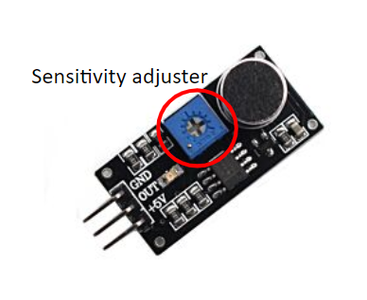

Step 3: Sensor Calibration
If you notice your LEDs are lighting up even in the absence of sound (or the opposite, they aren't lighting up at all), use a screwdriver to turn the sensitivity knob (see image above) until the LED reacts to sounds.
