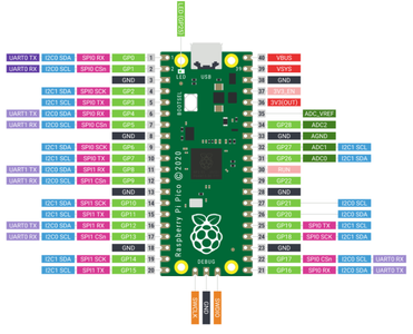

Step 1: Add Pico to Breadboard
Attach Pico to the top of the breadboard, and use the diagram above to reference the pinouts as we progress with the circuit.

The sound sensor has three different pins that require connection:
OUT (output)-- connected to pin 1 (GP0)
GND (ground)-- connect to any one of the ground pins on Pico. For this one I used pin 33.
VCC (power source)-- Pin 36- 3V3(OUT)
Reference the image above to see how the finished connections should look.
