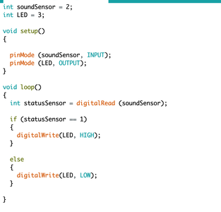

Step 2: Code:
1. Open uno on your desktop and start a new sketch.
2. The sketch should start by identifying the integers. Because we connected the LED to the 3 on the Uno board, the int in the code for LED is 3 and the sound sensor is 2 for the same reason.
3. After that you need to identify the sound sensor value as one for your if statement because 1 identifies the sound being picked up. Then identify the digital write of the LED as High so it turns on or becomes higher when triggered ( you can change that through adjusting the sound sensor).
4. Your else statement should continue the common of the LED as LOW to allow the light to go off or become lower when no sound is detected.
