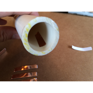

Step 1:
Tear pieces of copper tape approximately one inch long. Tear enough tape to make a pad on which the the marble fits.

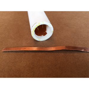

Step 2:

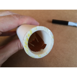

Remove the backing from the conductive copper tape. Using needle nose pliers and a closed pen or your fingers, carefully adhere the tape to the inside of the PVC tube parallel to the length of the tube. Continue placing pieces of copper tape next to the other strips, trying to make each strip overlap slightly the strip next to it.
Step 3:

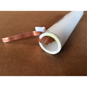

Tear a piece of copper tape approximately four inches long. Remove the backing. Adhere it to the pad of copper tape inside the PVC tube. Continue affixing the copper tape to the PVC tube over the lip and down the exterior of the tube a couple of inches. Finish off the copper tape by doubling it over on itself to leave a flap of copper tape.

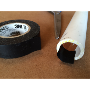

Step 4:
Cut a small piece of electrician’s tape with the scissors. Apply the electrician’s tape over the conductive copper tape at the lip of the PCV tube. You want to insulate the copper tape where it leaves the pad of copper tape inside the PCV tube and crosses over the lip of the tube. Make sure you leave the copper tape pad uncovered by electrician’s tape.

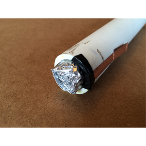

Step 5:

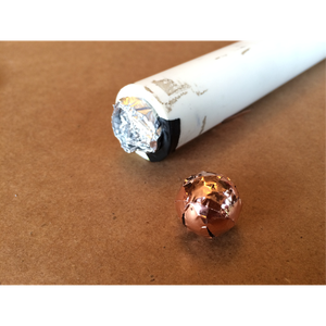

Fold a piece of aluminum foil until it is a small strip. Roll the strip into a coil and test how it fits inside the PVC tube. You might need to add additional strips of foil to the coil to make it fit snugly inside the PVC tube.
Step 6:
Wrap the marble in even strips of conductive copper tape. It is easiest to wrap the marble along the circumference, turn it, and repeat two more times. This covers the marble sufficiently and does not waste conductive copper tape.

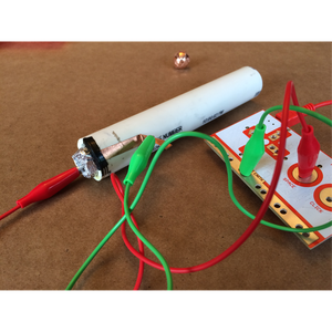

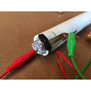

Clip one alligator clip to the copper tape on the side of the PVC tube. Clip the other end of this alligator clip to the Earth on the Makey Makey. Clip another alligator clip to the aluminum foil in the PVC tube. Clip the other end of this alligator clip to the Space key on the Makey Makey.
Step 8:
Connect the Makey Makey to the computer with the USB cable.
Step 9:
Place the conductive marble in the PCV tube. Tilt the tube. When the marble reaches the aluminum foil “plug” at the end of the PCV tube, make sure the ground copper tape pad is at the bottom of the tube, facing the floor. The marble will be in contact with both the copper tape pad and the aluminum foil, completing the circuit. Confirm that the green light illuminates above the “Space” key on the Makey Makey.

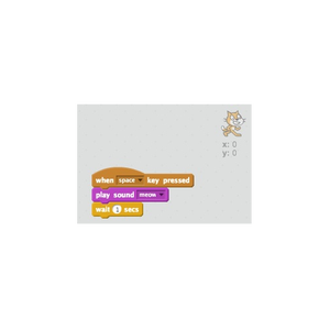

Open your web browser and load https://scratch.mit.edu. Create a new project. Connect blocks like these to react to the Makey Makey tube being tilted.
Here is an example you can remix:Scratch linkhttps://scratch.mit.edu/projects/78497848/
Click here to remix this project in Scratch
