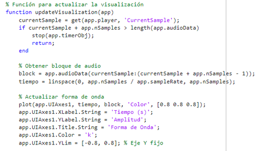

Step 2: Waveform Plotting
The method starts by obtaining a block of audio samples. The currentSample variable keeps track of the current position in the audio data. A specific block of samples, defined by nSamples, is extracted. This block represents a small portion of the audio data at a given moment.
This block is then plotted as a waveform on the UI axes (UIAxes1), showing the variation in amplitude over time. The x-axis represents time (in seconds), and the y-axis represents amplitude. The waveform is updated continuously during the playback of the audio.

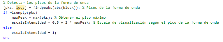

Step 3: Peak Detection
The findpeaks function is used to identify significant peaks in the waveform data. Peaks are the points in the audio waveform where the amplitude is higher than its surrounding values. These peaks are used to assess the overall intensity of the sound. The maximum peak value (maxPeak) is used to adjust the scale for the next visual layer's intensity.

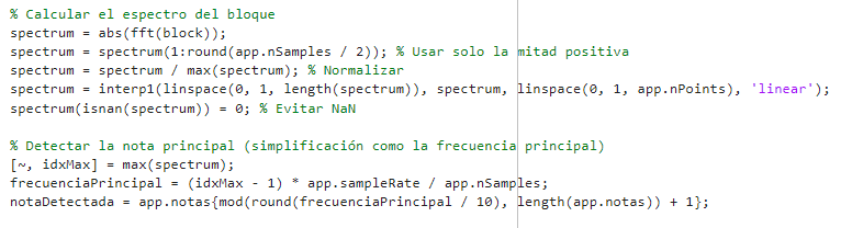

Step 4: Frequency Spectrum Calculation
The Fast Fourier Transform (FFT) is applied to the current audio block to analyze the frequency content of the sound. The FFT converts the time-domain signal (waveform) into the frequency domain, allowing the system to identify the dominant frequencies present in the audio block. The magnitude of each frequency is stored in spectrum.
Only the first half of the FFT result is used since it contains the positive frequencies. The spectrum is then normalized, and linear interpolation is applied to match the number of points required for visualization (nPoints).

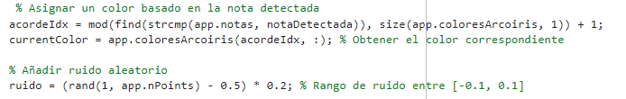

Step 5: Main Note Detection
From the calculated frequency spectrum, the code identifies the frequency with the highest magnitude (idxMax). This corresponds to the dominant frequency in the audio block. Using the position of this peak, the algorithm calculates the corresponding musical note.
The frequency is mapped to one of the notes defined in the notas array. A simple mapping is performed by rounding the frequency and using modulo arithmetic to select a note from the array.

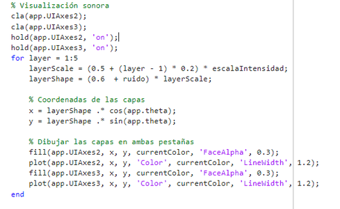

Step 6: Dynamic Layer Visualization
After detecting the main note, the method proceeds to visualize the sound. The visualization is dynamic and consists of concentric layers (represented as ellipses) that grow and change based on the sound's intensity and the detected note.
The color of each layer is based on the detected note. The coloresArcoiris array provides a range of colors corresponding to different notes. Each layer is scaled according to the intensity of the sound and noise is added to add randomness to the visualization.
For each layer, x and y coordinates are calculated based on the radius and the angle (theta). The layers are drawn using the fill function on the UI axes (UIAxes2 and UIAxes3), and the resulting effect is a circular, dynamic visualization that responds to the sound's characteristics.
Multiple layers are drawn with increasing scale, creating a visual effect that expands outward. The color, opacity, and position of the layers are adjusted dynamically as the audio plays, creating a rich and responsive visualization.
