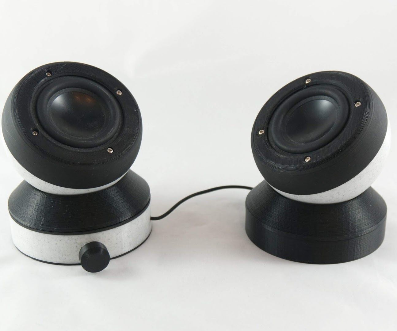

This project came about after watching this video by a youtuber who described a way to visualize sound with a laser. It works by taking a speaker, stretching a balloon over it, and centering a mirror fragment on the balloon. Sound is played through the speaker and a laser pointer is shined on the mirror. The sound causes the mirror to vibrate, creating a laser show. I designed the speaker above so I can mix frequencies and play with the various shapes. Since I don’t own a speaker, I thought this would also be a good opportunity to learn how sound systems work while making a high quality speaker.

- Solder wires onto the terminal of the speaker (yellow - positive : green - negative). Screw the speaker onto the top half of the speaker. Push the magnets into place. The magnets are for connecting the top half and bottom half together for upgradability. While it is currently running off a 12v socket, I’m hoping to upgrade it with built in batteries and bluetooth.
- Push the amplifier through the front hole. Use the nut that comes with the amplifier to clamp it into place. Insert the speaker wires into either the right or left output ports.
- Insert the 1/4” hex nut in the slot on the side of the top half case.

- Pass the wires through the pin and snap into the hinge hole on the side of the speaker base. Pass the wires through the side of the speaker case.
- This next part is a little unsettling, but bear with it. Push the cover into the pin. Angle it so that the case fits in a little better in the base. You might have to bend the base a little for the speaker to fit.
- Assemble the knob for clamping the speaker case in place. Push the hex screw into the knob print. This is optional, but it makes the knob look much better. Put hot glue in the remaining space of the knob and place the cover for the knob to hide everything.
- Wire everything as shown above. 12v cables into the input for the amplifier board. For the audio; yellow to left, blue to ground, and green to right audio input.
- Place magnets on the bottom case and snap the speaker cases together!
