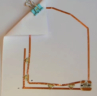

Step 1:
That's how the circuit looks inside of the clock.
When you blow on the paper, LEDs light up.
Binder clip is holding the battery
Step 2:
Open your clock and draw the circuit if you wish.
Then, make the circuit real by adding copper tape, sound sensor and LEDs.
Step 3:
Put back together the clock and add the battery.
I used binder clip to hold the battery.
I also added another binder clip to act as a feet.
That's it.
Blow, shout or tap on the clock to see the time.
