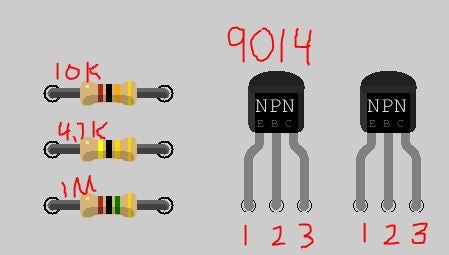

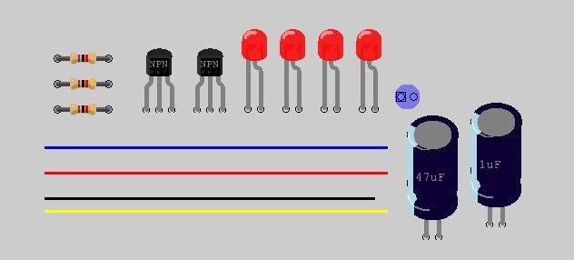

Step 1: Parts List
Resistors 10K 4.7K 1M
Capacitors 1uF, 47uF
Transistors 9014 (Click for datasheet)
3mm Leds
Jumper Wires (Buy now)
Electret microphone

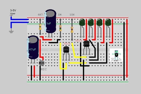

Step 2: Connect the Components
Lets get started.

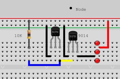

- Arrange your leds in parallel on the bread board. (The flat side of the led is ground)
- Connect the positive side of the leds to VCC.
- Add a 9014 transistor to the board.
- Connect a jumper between the last leds in parallel and the Collector of the 9014.
- Ground the emitter. (pin 1, EBC)
- The Base of the 9014 is connected to a 10K resistor.
- The 10K resistor is connected to VCC on its other end.
- Next add another 9014. The Collector (pin 3, EBC) will join the 10K resistor and the Base of the 1st 9014.
- Ground the emitter on this transistor as well.
- The Base of the newly added transistor will join a 1M resistor & 1uF capacitor.
Step 3: The Microphone
Finishing up.
- One end of the 1M resistor should connect to the Base of 9014 Q1, connect the loose end to VCC.
- The 1uF capacitor's negative leg is connected to the Base with the 1M resistor.
- The loose end of the 1uF cap is connected to a 4K7 resistor AND the positive leg of the mic.
- The loose end of the 4K7 resistor is goes to VCC.
- Ground the negative leg of the mic.
- The last component is a 47uF capacitor. It is connected to VCC on one end and grounded on the other. This is used to filter the noise.
- Please double check your connections before proceeding.
- You are now ready to apply power (3V-5V) to the bread board :)
Step 4: Test the Circuit
If your circuit is working properly your leds should light up at the sound of your voice or music.
The louder the sound the brighter the leds!
