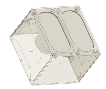

Step 1: DESIGN

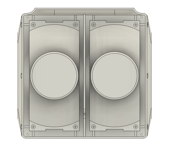

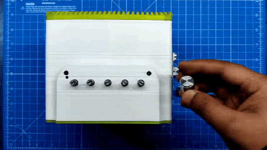

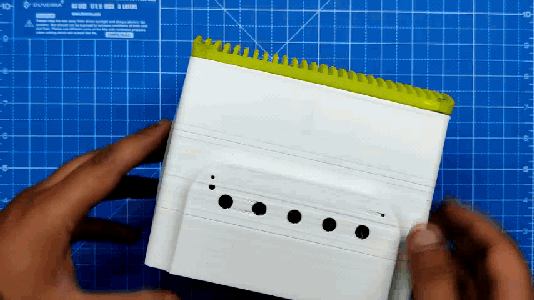

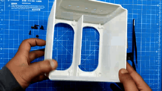

Here is the simple design I came up with. The entire body is designed in the shape of a cube, and the front has a speaker grill created of splines.
Control knobs for the Audio Module were positioned on the top face, and an RGB LED diffuser that lights up the background is located on the rear side of the speaker.
Additionally, there are two rocker switches on the bottom side that control the power supply for the speakers and the RGB light. A DC Jack is located on the back of the device to charge the battery.
Regarding the internals, we put the two speakers we used on the interior of the front face of the project.
The speaker grill was modeled to fit on the front face using four M3 screws situated at each corner.
We have created a holder element that is first secured to the mounting holes on the audio module, and then the entire assembly is fixed within the base to keep it in place.
After exporting each component into an STL file, they were all 3D printed using white PLA and golden yellow PLA with a 0.2mm layer height and a 1mm nozzle.

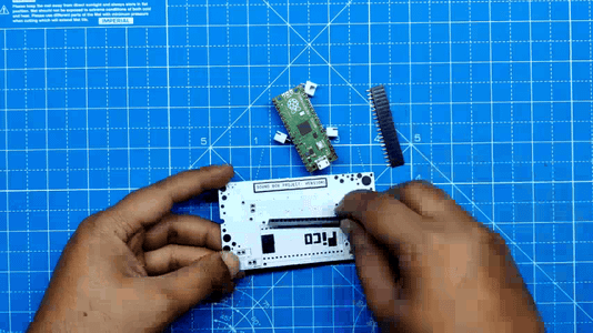

Step 2: PCB Design
The PCB design of this project's RGB board was super simple, as it only contains an array of WS2812B RGB LEDs connected in parallel with an Raspberry Pi Pico.
The schematic was made in a total three sections, which were the AMS1117 and battery sections, the Raspberry Pi Pico Setup, and the WS2812B LED array.
We needed to add an AMS1117 voltage regulator configuration in order for the Raspberry Pi Pico and LEDs to function because we were utilizing a 12V Li-ion battery as our power source. This arrangement steps down the 12V of the battery to a steady 3.3V.
Two capacitors are connected to the input and output terminals of the AMS1117 in the simplest configuration. A 10 uF 1206 capacitor is attached to the input side, while a 1 uF 1206 capacitor is linked to the output side. Additionally, an M7 diode and a switch have been placed between the input con2 terminal and the ams1117. A DC jack will be added using the CON2 to charge the 12V battery.
Each RGB LED was connected to a 100 nF capacitor for decoupling of the supply line.
Following the creation of the schematic, we create the PCB design and layout the components on the board, based on the PCB model created in Fusion 360.
All of the SMD components, RGB LEDs, and the AMS1117 setup were mounted on the bottom. On the top side of the PCB were Pico along with additional THT components.

Step 4: PCB ASSEMBLY
  • Using a solder paste dispensing needle, we first add solder paste to each component pad individually to begin the PCB assembly process. In this instance, we are using standard 37/63 solder paste.
  • Next, we pick and place all the SMD components in their places on the PCB using an ESD tweezer.
  • With extreme caution, we lifted the complete circuit board and placed it on the SMT hotplate, which increases the PCB's temperature to the point at which the solder paste melts and all of the components are connected to their pads.
  • Next, we add all the THT components, which include the header pin, Raspberry Pi Pico, and CON2 JST Connectors, to their locations and then solder their pads using a soldering iron.
THE PCB IS NOW READY!

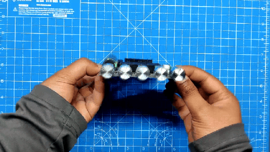

Step 6: Audio Module and Sound Hardware
The ZK-TB21 is being used in this project, which is a 2.1-channel audio power amplifier based around the TPA3116D2 power amplifier chip.
TPA3116D2 is a Class D stereo amplifier that can drive speakers up to 100 watts. To drive two 100-watt speakers, the ZK-TB21 utilizes two of these TPA3116D2 chips. one for the left and right speakers, and one for the subwoofer
Also, there's a Bluetooth audio IC on this board, which lets us connect with this board for audio streaming.

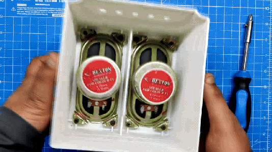

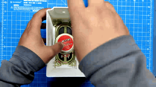

Step 7: Speaker Assembly

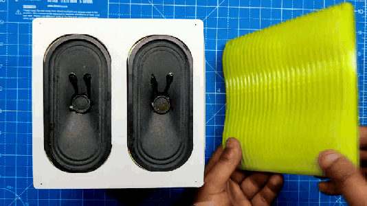

First, we assembled the speakers, which was quite easy.
We take the two 15-watt speakers and install them inside the main base.
Eight M2 screws were used to permanently fix the speakers after they were positioned inside the main base in their designated spots.

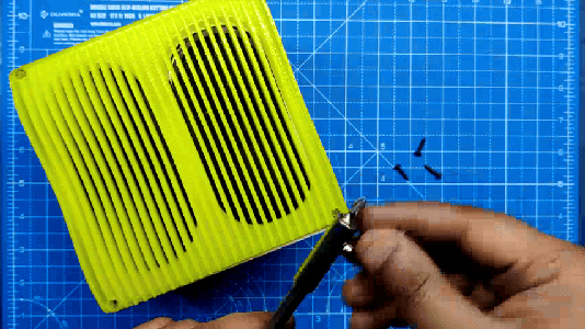

Step 8: Speaker Grill
Next, we use four M2 screws to add a grill to the front of the main body.

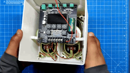

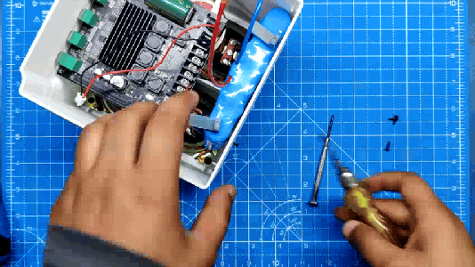

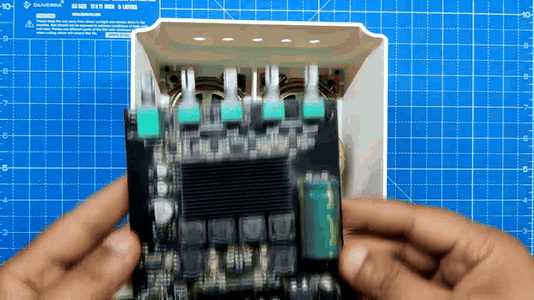

Step 9: Adding the Audio Module Inside Base
As explained earlier in the design process, we have modeled an audio module holder part that is mounted with the audio module so that the entire assembly can be placed inside the speaker body vertically.
  • The audio module is positioned atop the holder component, and four M2 screws are used to secure both of them in place.
  • Next, we take the whole assembly and slide the audio module into its place.
  • At last, we use four M2 screws and secure the audio module holder assembly in its place.

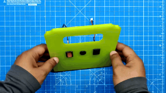

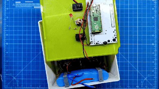

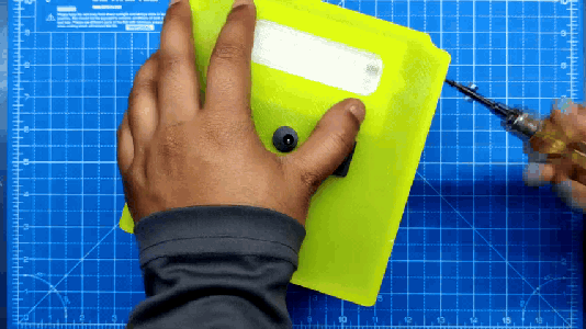

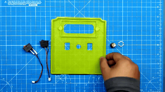

Step 11: Back Lid Assembly
  • Before beginning the Back Lid assembly process, we gather all of the remaining components, which include one DC barrel jack and two rocker switches.
  • The JST CON2 Wire Harness was attached to the terminals of both Rocker switches, so connecting them to the RGB LED Board is as simple as putting in the wire harness connector on the PCB connector.
  • We place both rocker switch in their place, along with the DC Barrel jack.

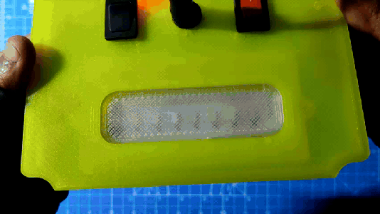

  • Subsequently, we set the RGB LED board in its designated spot after adding the diffuser, keeping the diffuser between the PCB and lid.
  • PCB is then secured using two M2 Screws.
  • Next, we add both rocker switch wire harness on the CON2 of the RGB LED PCB.

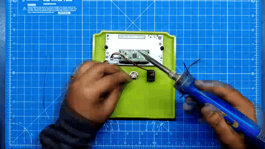

Step 12: Back Lid Assembly: DC Jack Wiring
  • We connect the cathode of a diode to the charging connector of the RGB LED PCB and place it in series with the input terminal of the DC Jack.
  • In order to serve as a charging indicator when the charger is plugged in, we additionally add an LED to the input side of the DC barrel connector that is coupled to a 1K resistor.
  • By passing a 12V power supply through the DC barrel connector to test the setup, we can see that the RGB board is receiving power and that the indicator LED lights up.

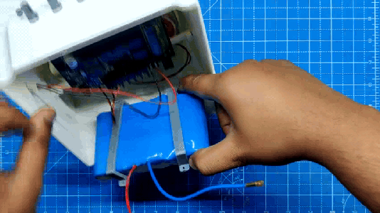

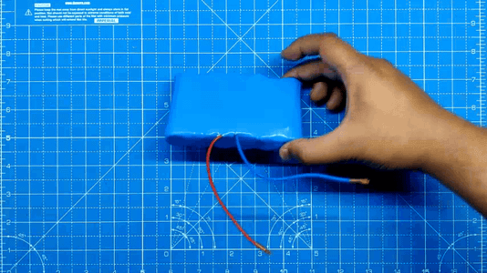

Step 13: Power Source
As for the battery source, we are using a 12V 5.2Ah Li-ion Battery Pack which contains an internal BMS, which means this pack offer over charge and overdischarge cutoff feature.
We constructed two battery pack clamps to attach the battery pack within the base. Four M2 screws are used to fasten the clamps to the base body, holding the battery pack in place.
Step 14: Final Assembly
  • The last step in assembly is to connect the power wire harness of the Audio Module to the RGB LED Board's audio connector.
  • next, we solder the battery terminals to the RGB LED Board's battery terminals, and the wiring process is complete.
  • After sliding the lid into position on the back, we fasten the main body to the back lid using six M2 screws.
  • Lastly, we install the potentiometer knobs that came with the Audio Module kit on them.

Here's the END RESULT of this simple build, a Loud Boxy Sound System which looks like a cube.
We tested the audio quality by pairing an IPAD with this Sound BOX via Bluetooth and playing a few songs. You can listen to the music for yourself by watching the video below.
An intriguing addition to this speaker was the RGB LED that illuminates the background and plays the Pacifica animation continuously.
