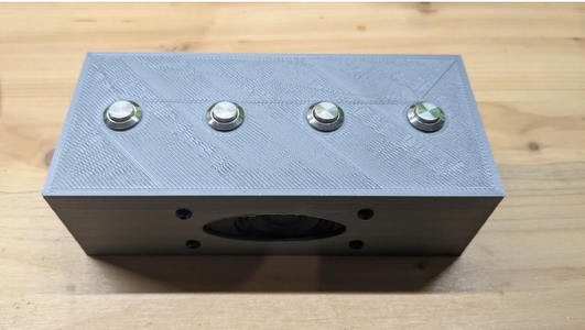

Housing
After testing the project on the Breadboard, you can finally go to a 3D-Build printed housing. The button is suitable as a button as a replacement for the previous microphone buttons, as they can simply be screwed into the housing.
Print the.STL Files (Soundboard3d.stl, Soundboard3dtop.stl) with a 3D printer and assemble the button in the lid. You can solve the electronics to the 5x7 cm PCB with corresponding box strips. A 9V block battery on the VIN and GND connection can be closed to the power supplyn und are placed in the housing.
You are welcome to expand the project according to your ideas. For adjustments to the housing, they stand Raw files (Soundboard3d.fcstd, Soundboard3dtop.fcstd) available. This can be individually edited in Freecad, a free open source program.
