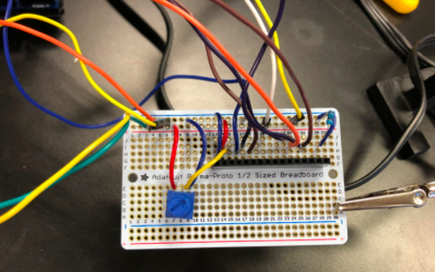

      Step 1: Circuit Design
      The following are step by step instructions for how to build the circuit for the project using a breadboard. Later on, the circuit will be soldered to a prototype board, but this part of the project is important to make sure all of your hardware components are working properly.

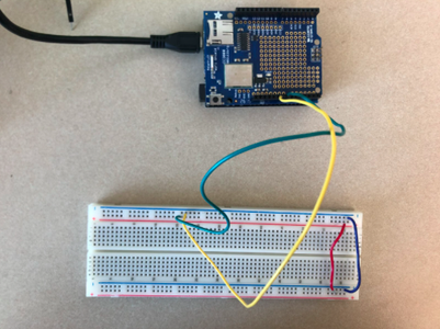

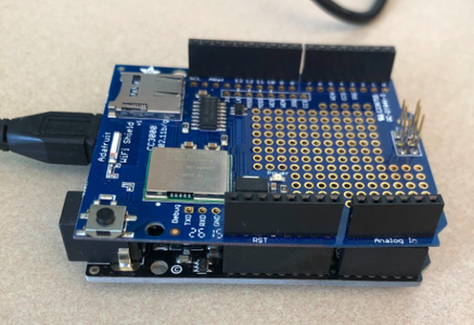

      Step 1: Plug the wifi shield into metro microcontroller. Run macarl21_buildtest to confirm that the wifi shield is working.

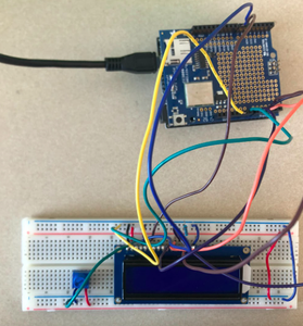

      Step 2: Connect ground to blue rail and 5V power to red rail on a breadboard. Use two additional wires to connect the left and right side red rails and left and right side blue rails to one another.

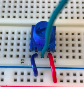

      Step 3: Plug in a potentiometer. Connect leftmost pin to ground and rightmost pin to power. Attach wire to middle pin (will be used in the next step).
      Step 4: Plug in the LCD screen to the breadboard. Then wire the LCD screen according to the pinmap in the following table.
      Step 5: Run macarl21_HelloWorld and confirm that the lcd screen displays “hello, world!”.

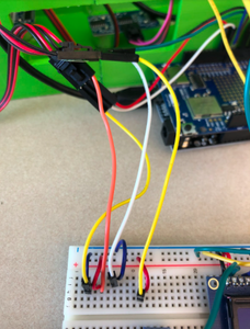

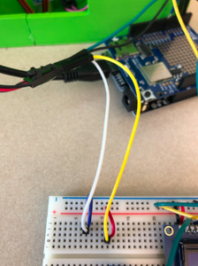

      Step 6: Wire the first proximity sensor according to these pin assignments (the first pin is the motion sensor and the second pin is the wifi-shield pin/board):
      • GND - GND
      • ECHO - 4
      • TRIG - 2
      • PWR - 5V
      Step 7: Wire the second proximity sensor according to these pin assignments (the first pin is the motion sensor and the second pin is the wifi-shield pin/board):
      • GND - GND
      • ECHO - 8
      • TRIG - 9
      • PWR - 5V
      Step 8: Run macarl21_motionTest and confirm that the proximity sensors output changes logically as the distance from the sensor to an object changes.

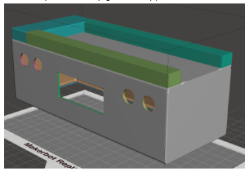

      The images above show the 3D model for the hardware casing. The model has been turned upside down and it is broken up into different pieces, each with their own file, so that it is easier to print.
      Case Part 1 and 2 (the first four images shown above) are the two halves of the main housing for the hardware components. When the two halves are brought together, its dimensions are 250 x 93.4 x 140 millimeters. The main case has holes in it that each serve a different purpose depending on the hardware component it is associated with. The large rectangular hole on the front is for the user to have access to the LCD screen. The two pairs of holes right next to the screen hole are for the motion sensors. They will allow the signal emitted by the sensors to exit the case, and detect if an object is in front of it. In Case Part 2, there is a slightly larger hole on the side of the case that will allow the power cable to connect to the microcontroller.
      The Completed Case (the 5th and 6th images shown above) shows the main case when the two halves are brought together and turned right side up. Here, you can better understand what the final product will look like. The space on the top of the case is meant to accommodate the planter tray and the planter itself. The dimensions of the planter tray are 6.9 x 3.3 x 2.5 inches, so the space must be at least that large to fit the tray. Turning to the bottom of the main case, this space is one large hole that is meant to give access to the interior.

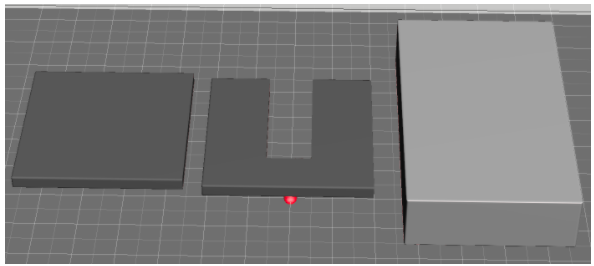

      The Smaller Pieces file (second to last images shown above) are different pieces that each serve a different purpose. The two small panels on the left hand side of the image will be used to secure the hardware components once they are inside the main case. A small velcro patch will be stuck to the panel and its corresponding hardware component, and then a hot glue gun will be used to secure the panel, along with the component, to the inside of the case. Care must be taken to make sure that the components are in the correct positions for the system to work properly. The larger block piece on the right hand side of the image will be used to close off the area on the top of the case, where the planter tray will go. This piece will be secured in place by sticking a velcro patch to the bottom of it, and sticking another velcro patch to the top of the case, in the proper position. This will allow people to easily secure and remove the block and the planter tray as needed.

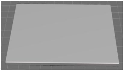

      The Bottom Panel file (last image shown above) is a large panel that will be attached to the bottom of the main case using velcro patches. This is meant to close off the case once all of the hardware components have been secured inside. Using velcro patches to secure the large panel to the bottom of the case means it can be removed easily if needed. It is important to note that this file only contains one half of the panel so that it is easier to print. Its dimensions are 125 x 5 x 140 millimeters. It will need to be printed twice to get the complete panel.

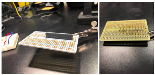

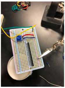

      Step 4: Soldering the Prototype Board
      Materials for Soldering:
      • Solder metal
      • Solder tool
      • Prototyping board
      • Board pins

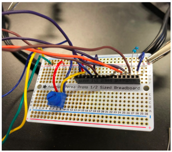

      Step 1: Solder the pins of the black piece (shown in the 1st and 2nd image above) to the prototype board. This will be used later to connect the LCD screen to the board.

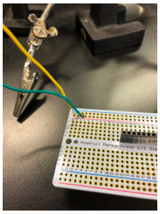

      Step 2: Connect jumper cables to the ground and power bus of the board, and also to the ground and power pins on the microcontroller.
      Step 3: Solder the potentiometer to the prototype board, and connect it to the ground and power bus of the board with jumper cables.
      Step 4: Solder connections to the pins for the LCD screen.
      Step 6: Solder ground and power wires for each of the proximity sensors.
      Step 7: Run macarl21_motionTest and confirm that the proximity sensors output changes logically as the distance from the sensor to an object changes.
