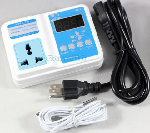

The heart of the sous vide cooker is a digital temperature controller.  You can easily find them on eBay for less than $25, including shipping.  Just be sure the controller you buy operates at 110V, and can display temperature in degrees Fahrenheit (if that's what you want).  http://www.ebay.com/sch/i.html?_nkw=temperature+controller+110v&_sacat=0&_odkw=temperature+controller&_osacat=0&_from=R40
Notice how the controller has 8 screw terminals (second picture).
3 & 4 - These terminals give the device power to operate.
7 & 8 - The temperature sensor connects to these terminals.
1 & 2 - When the controller senses that the temperature is below the set temperature, it closes this relay.  When it's at (or above) temperature, is opens this relay.  We'll use these two terminals to route power to an outlet.

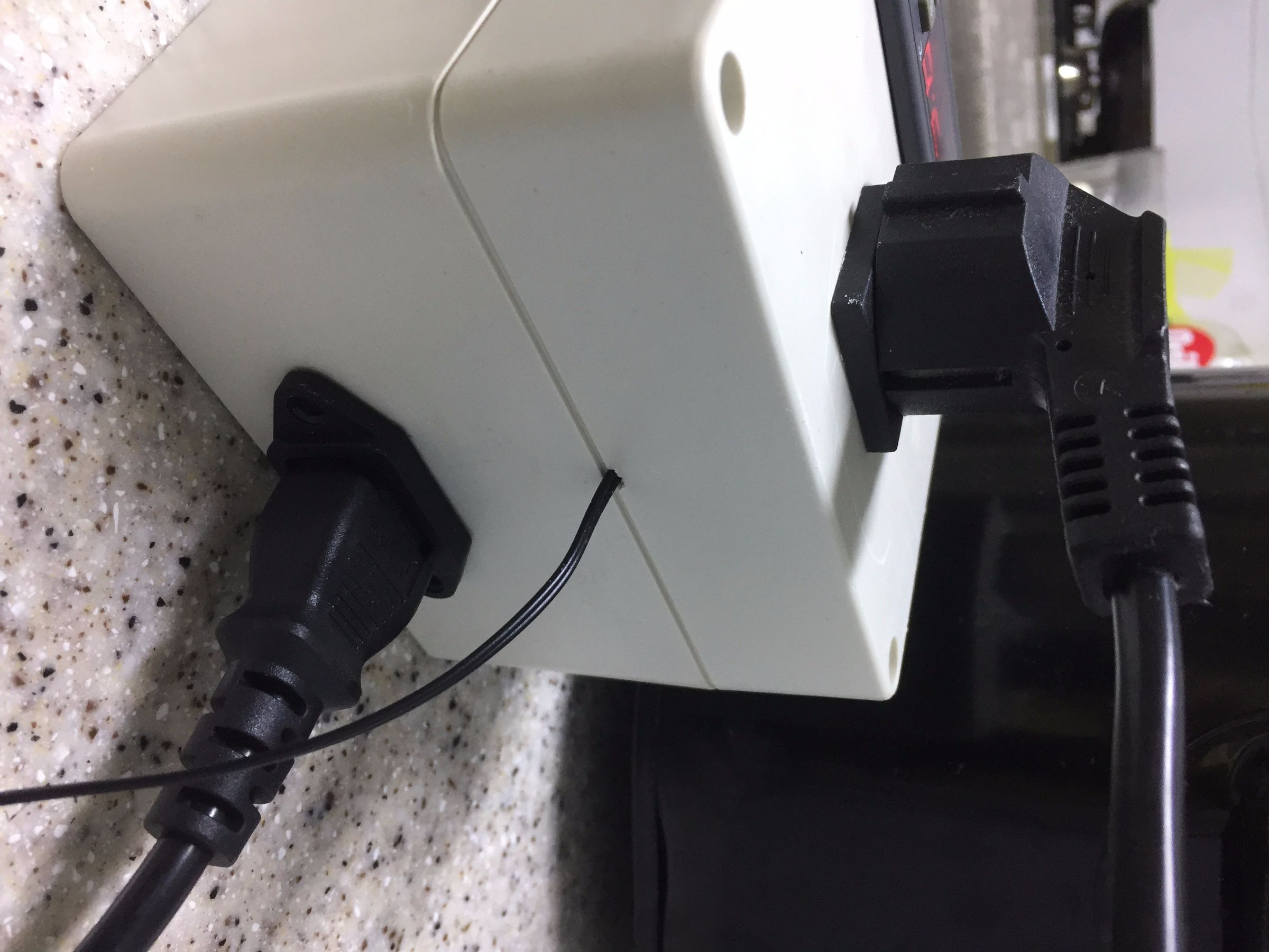

Step 2: Installing the C14 Receptacle
Create a template - It's pretty difficult to measure and draw on the plastic box, so I like to make a paper template and tape it to the side of the plastic box.  I use Google SketchUp because it's free, easy to create templates, and print them exact size.
Drill holes in corners - Use a small drill bit (e.g. 1/8") to drill holes at the corners of the template.
Dremel - Use a Dremel (or similar) tool to cut the straight lines.  Keep adjusting the hole until the C14 receptacle fits.
Mark screw holes - Insert the receptacle and mark the screw holes.  Drill appropriately sized holes for the screws you're using.
Install - Install the receptacle using short (e.g. 3/8") screws and nuts.

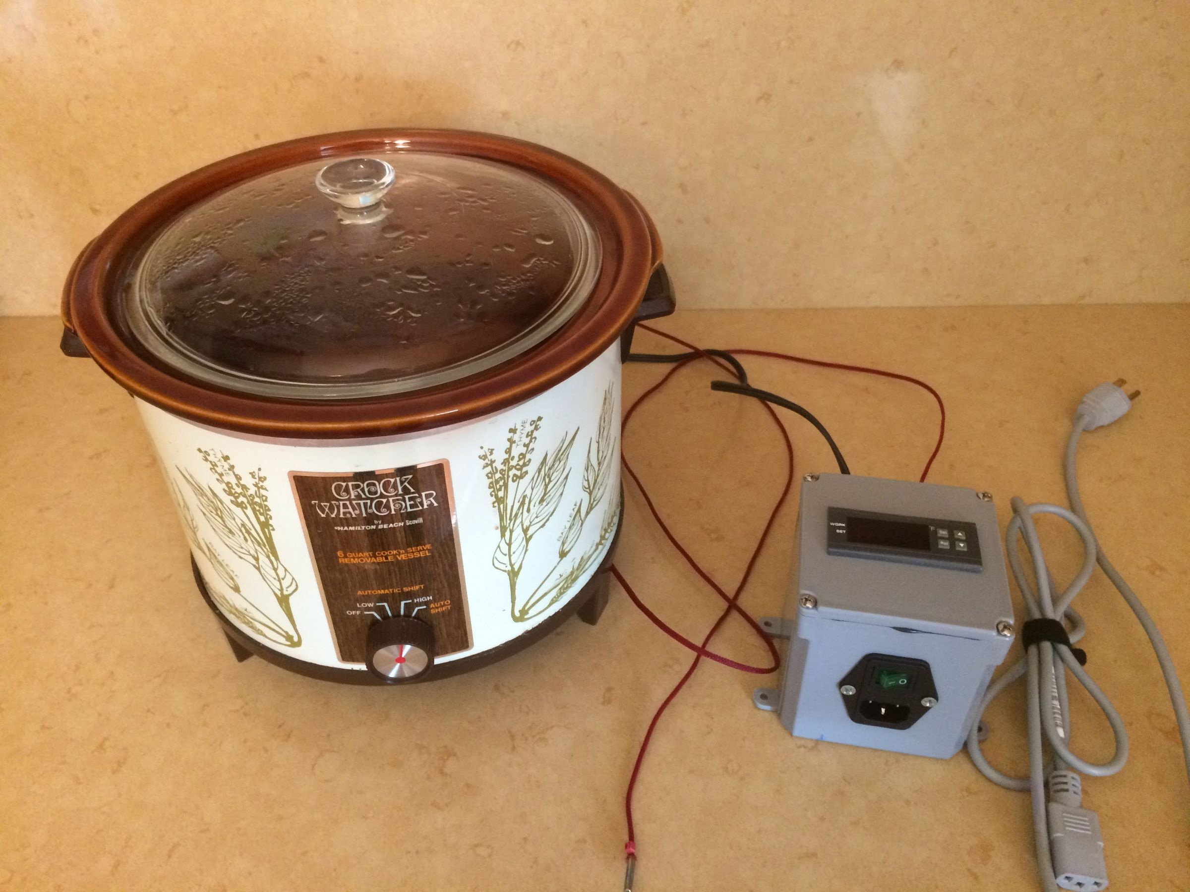

Step 4: Install the Temperature Controller
The temperature controller should fit snugly in the rectangular hole you made in the box top.  The face of the controller is slightly larger than the body, so any imperfections in the rectangular hole are hidden.
The controller is held in place with the orange clips.  The clips slide in grooves in the controller.  Snug them up tight against the top so the controller is secure.

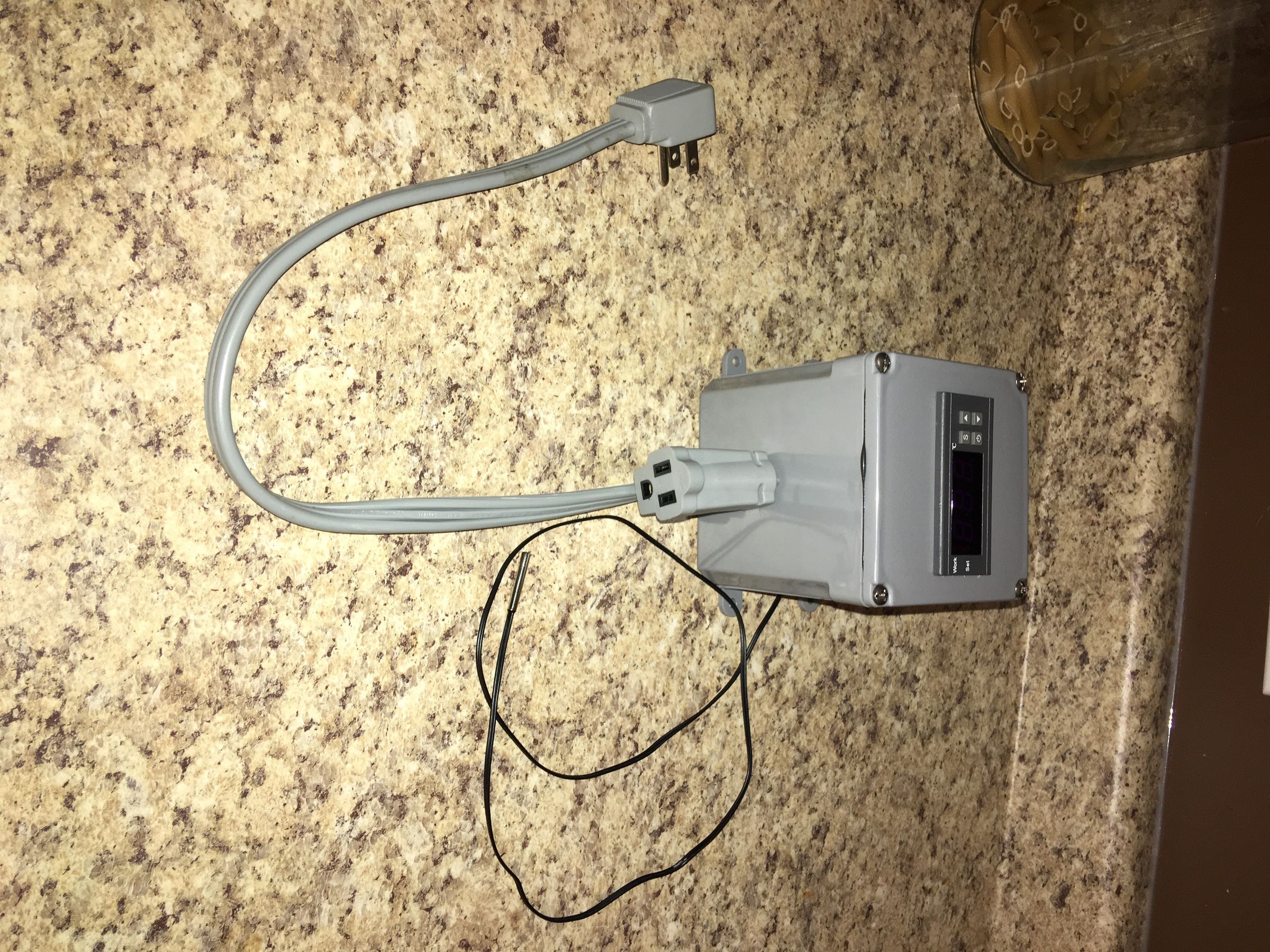

Step 5: Wiring
Ground - The ground wire on the C14 receptacle connects directly to the ground on the outlet.
Load - The load from the C14 needs to be split and connected to the relay pin (1) on the controller and to the power pin (3) on the controller.  The second relay pin (2) connects to the load of the outlet.
Neutral - Connect the neutral wire on the C14 receptacle to the neutral screw on the outlet.  Using the second neutral screw on the outlet, connect to the neutral pin (4) on the controller.
Note:  The female disconnects make it much easier to connect the load, neutral, and ground to the C14 receptacle.  Without them, you will probably need to remove the C14 to make the connections.
Temperature probe - Drill a small hole in the side of the box.  Pass the wires of the temperature probe through the hole, and connect to pins 7 and 8 of the controller.
Carefully tuck all the wires into the box.
Step 6: Testing
Testing is fairly easy.
1) Plug in your controller and you should see something on the display.

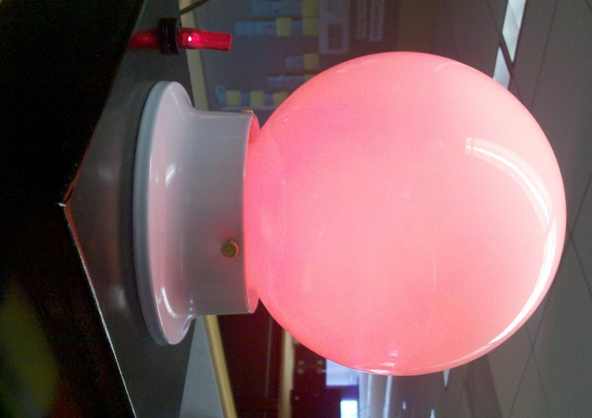

2) Plug a lamp into the outlet on top.
3) Press the "Set" button and release.
4) Press the up or down arrow to set the "cooking temperature."  For testing purposes, set it to 70 degrees.
5) Don't touch the temperature probe.  The controller should display the current temperature.  The "Work" LED will illuminate and the lamp will turn on.
6) Pinch the temperature probe between your fingers.  You'll see the temperature rise.  When it reaches 70 degrees, the "Work" LED and the lamp will turn off.
If something doesn't work, check your connections.  Something probably came loose while you were tucking wires into the box.

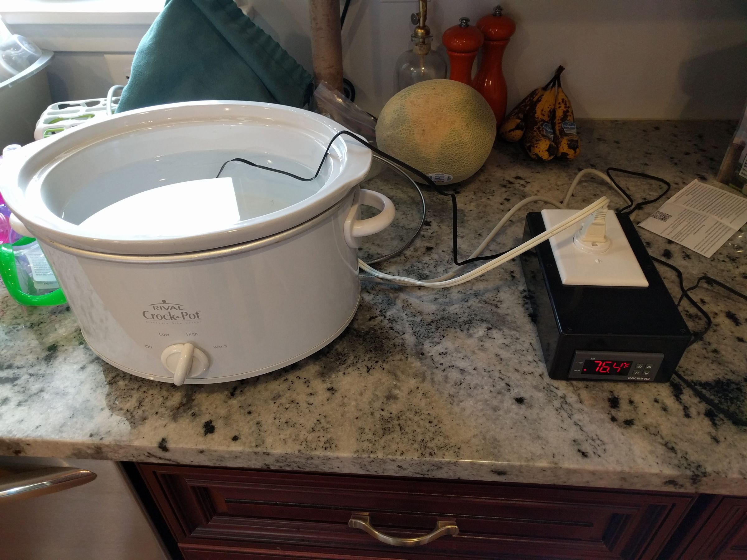

Step 7: Cooking Sous Vide

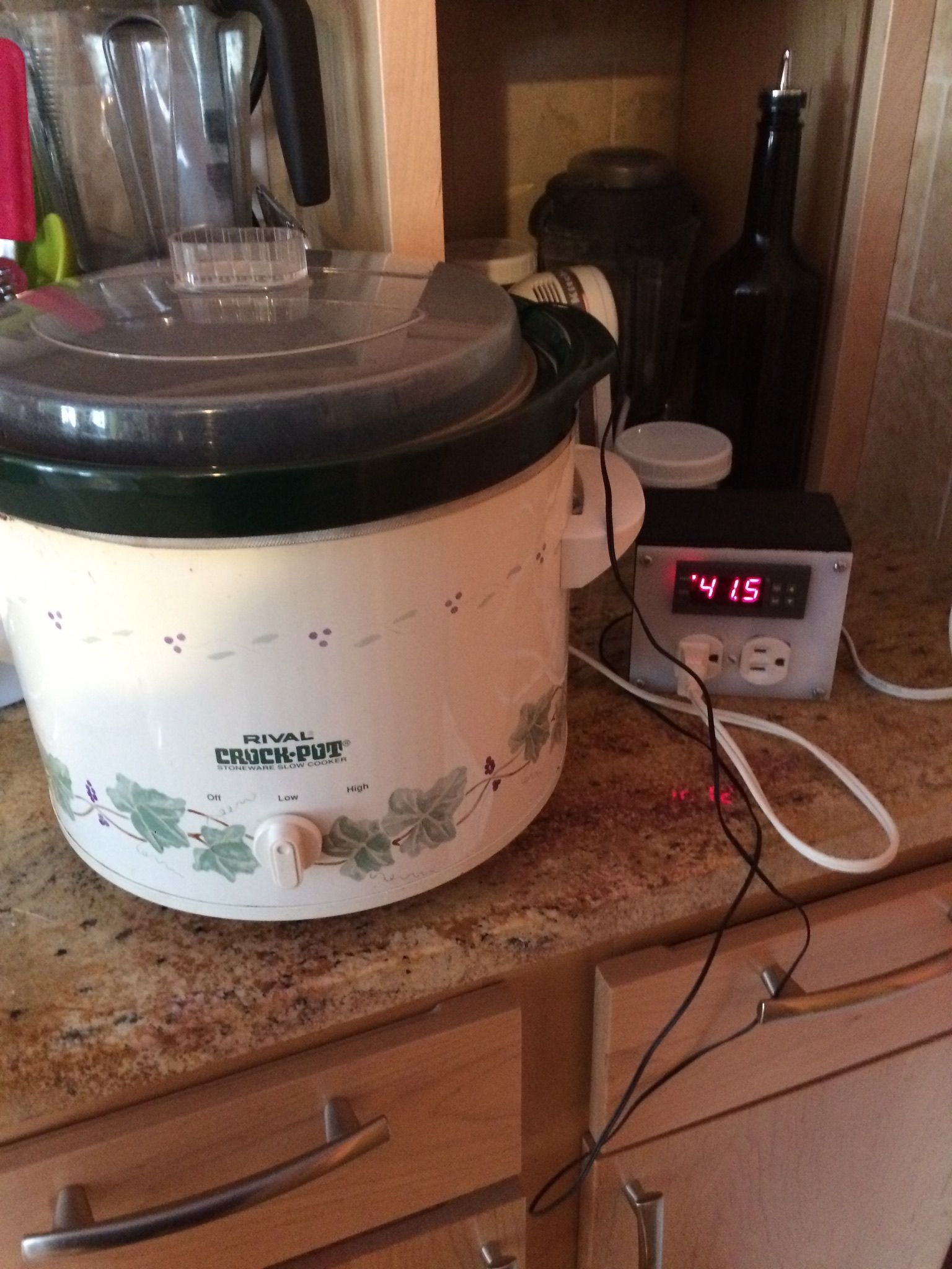

Prep the crock pot
1) Fill you crock pot with water.
2) Plug it into your sous vide controller.
3) Plug the sous vide controller into the wall.
4) Press the "Set" button and adjust the temperature.  My family likes our steak at 137 degrees.
Prep the steak
1) Don't even think of cooking $20/lb tenderloin.  The coolest thing about sous vide is that inexpensive cuts are fantastic.  I even had a guest tell me that a $4/lb round steak was the best steak she ever had!
2) I like to trim the steak so there isn't a lot of visible fat.
3) If you are cooking a roast, slice it into 1" thick slices.
4) Season the steak with a little salt and pepper, or steak seasoning.
5) Seal the steak in vacuum bags and drop into the crock pot.
6) Put the temperature probe inside the crock pot.  If I have more than one vacuum bag, I put the probe between them.
7) Be sure the crock pot is turned on.  Cover the crock pot with a towel for a little insulation.
8) Wait 4 to 8 hours.
9) You'll see the temperature controller cycle on and off, turning the crock pot on and off to maintain the perfect temperature.

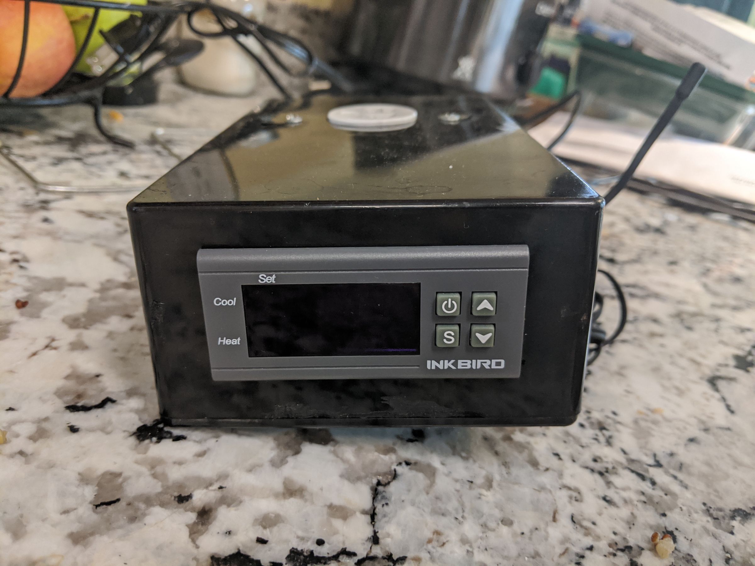

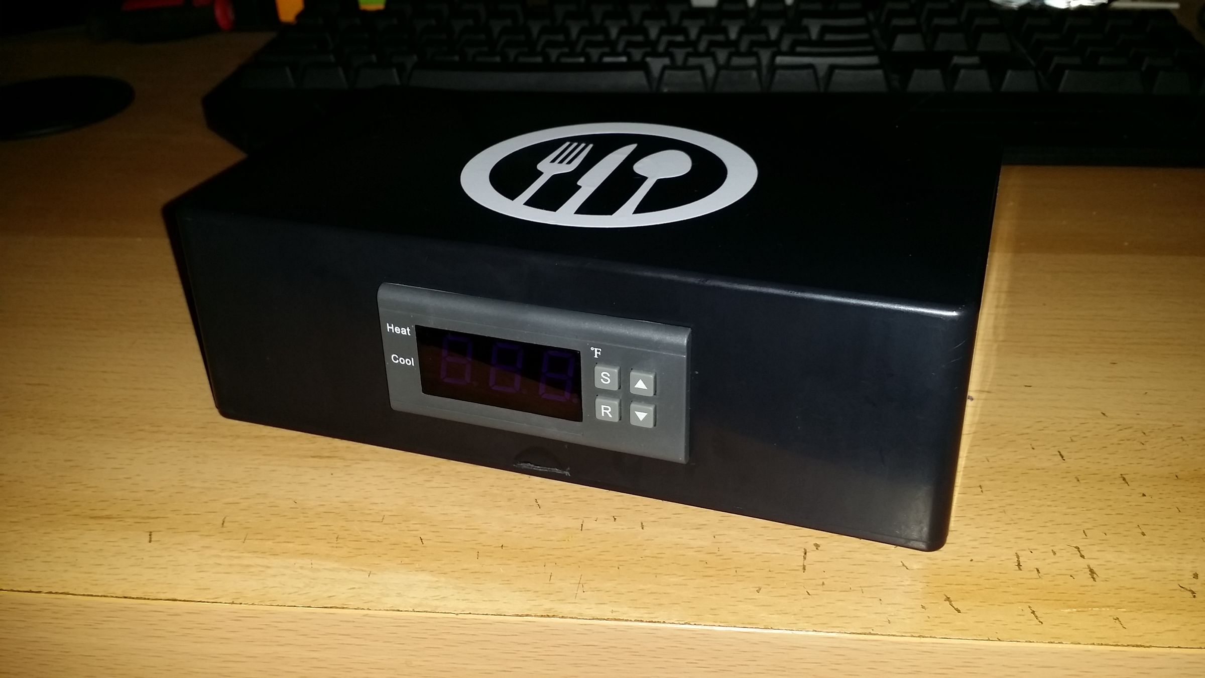

I made this exactly as instructed and it's completely awesome. Have since made three more for friends. I don't even know how to read an electrical diagram. I also made the vacuum chamber, also awesome, inexpensive, and highly useful. Will think of you every time I sous vide my sockeye!

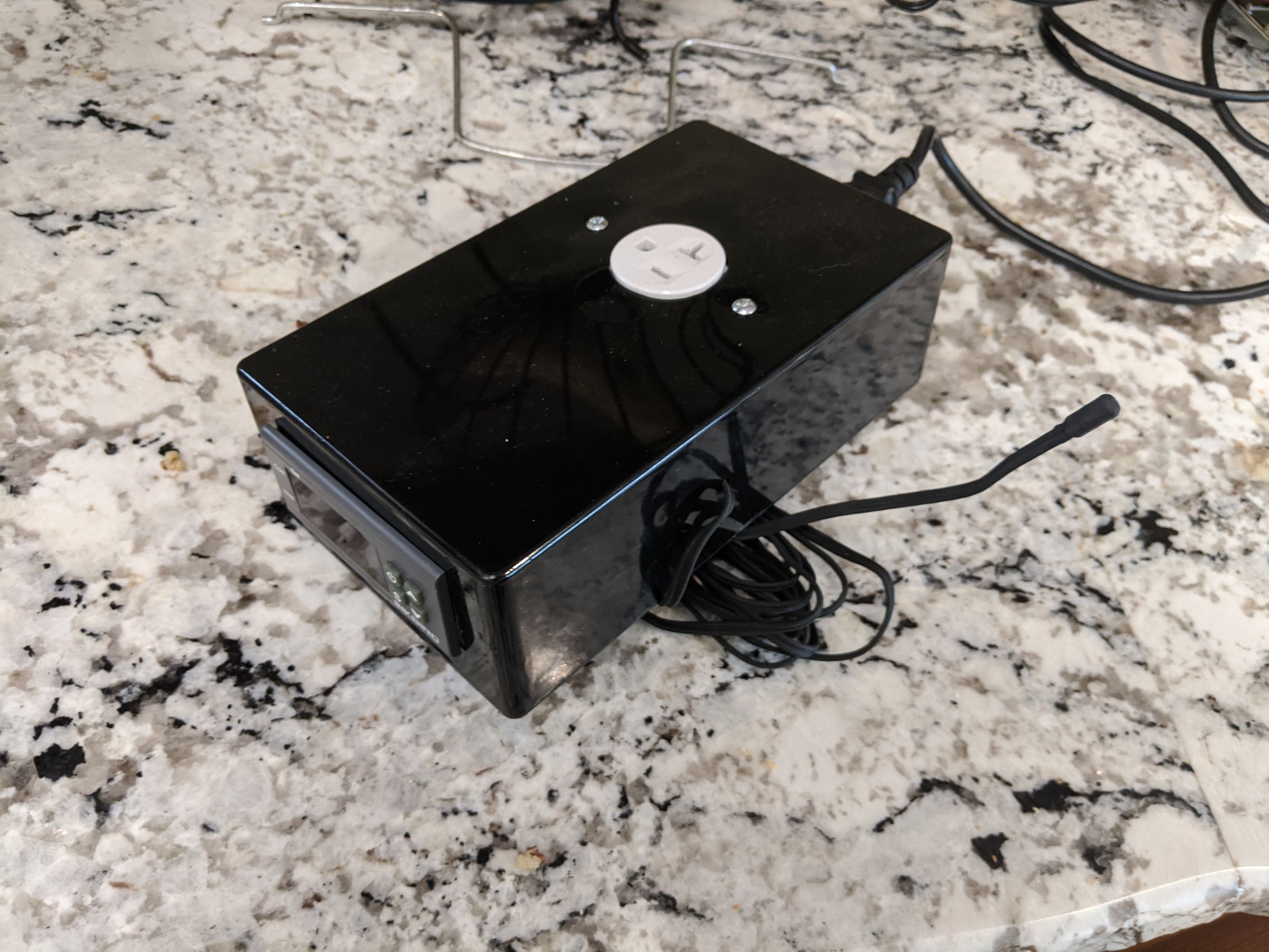

Followed this instructable last weekend with great success. Used the templates but had a different shaped project box. Overall very happy with how it turned out. Used it three times already in the week or so since it's been finished, and everything had turned out beautifully - including a 2lb roast.
Thanks for posting this!

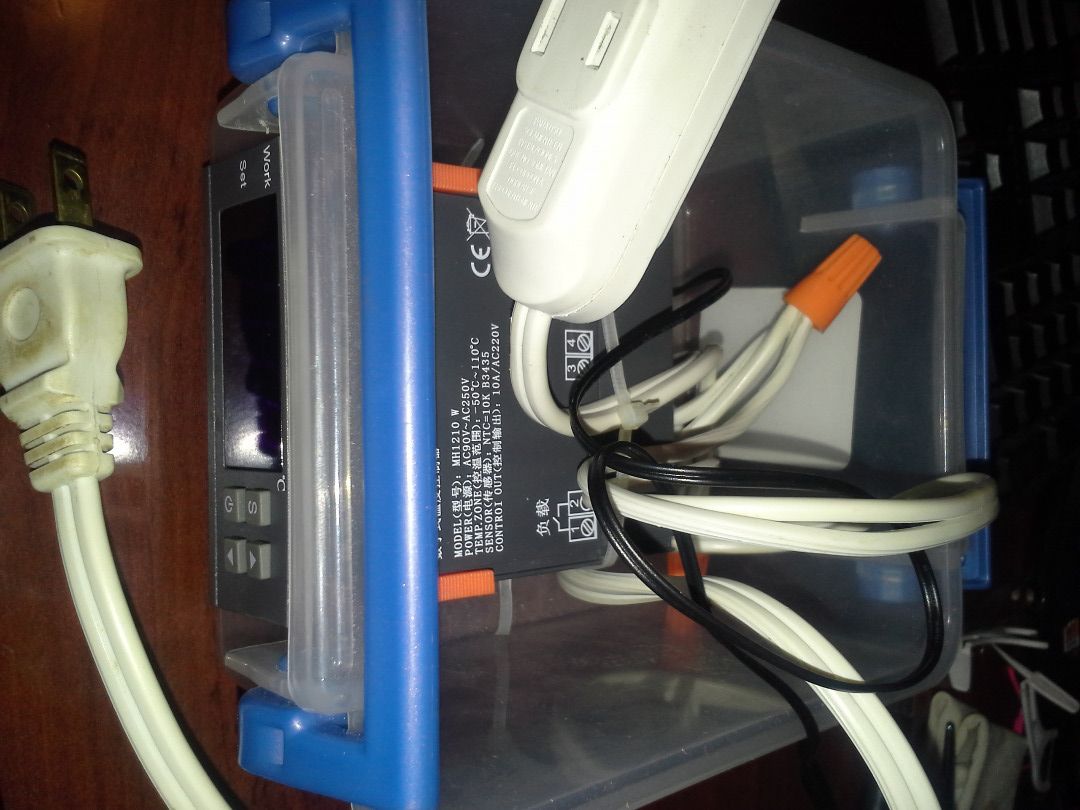

4 years ago

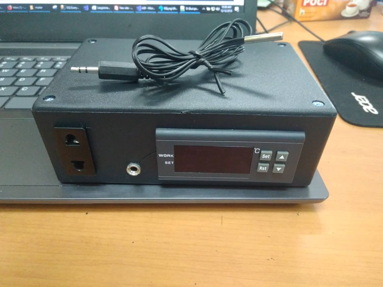

It's definitely been fun making two of these and of course using them for all things awesome in the kitchen, but China is catching up and ebay now has a controller for around $13. I ordered one to test it out and it works very well and does the same as the DIY one. It's also smaller and cheaper than making your own.
The advantage of the DIY is still that you can replace the temperature probe if it fails (which mine did) and that the controller itself can be customized a bit more. And of course it's more fun making your own :)
Here's the link to the one I bought: http://www.ebay.com/itm/391373376655 (you can also search ebay or google for "mh2000 temperature controller" to find it).

Hi, I've got the sensor working. However, how much water should I put in and should I close the lid? I read somewhere to fill 70% and close the lid. However, frequently, the temperature continues to increase pass the set temperature and overshoots by 5 - 10deg. It then slowly cools down until it reaches the set temperature. The sensor is turned on but it continues to cool again by 5 - 10deg. So how can I improve my situtation? Thanks!
0
burkelashell
burkelashell
Reply 4 years ago
I've had really good results, so I haven't experimented too much with these variables, but this is what I do:
-I fill the pot pretty much full. I think this prevents rapid temperature swings.
-I cover the pot with the lid.
-I put a towel over the crock pot to add some insulation.
I suspect your problem has to do with the temperature probe location. I like to put the probe next to whatever I'm cooking. I usually put a small bowl in the crock pot and put the packet on top of the bowl to keep it in the middle of the crock pot. For one packet, I usually place the probe between the bowl and the packet. If I have two packets, I place the probe so it sticks out between them.
I hope that helps. Do some experiments and let us know what you find out.

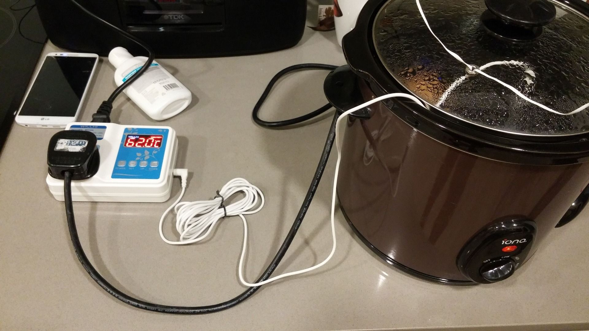

Most store boughten sous-vide cookers include a water circulation feature, but simple convection would seem to be sufficiently even for successful cooking. I suppose an aquarium pump would be easy to wire to this controller. Can't wait to put mine together.
0
harley1974
harley1974
Reply 4 years ago
New improvements as time goes on. Less than $15 US!

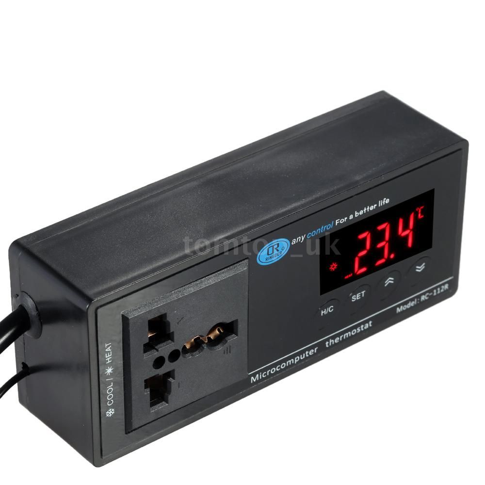

Temperature Controller Thermostat 110V, model RC-112R or RC-112
http://www.ebay.ca/itm/131741648218?ssPageName=STR...
I have no idea of the quality or actual usability of this since i've never used it, but it looks like an interesting development.

UPDATE: I've received the electronic temperature controller from ebay and tested it out with my analog crockpot and it works pretty great as a sous vide machine. (See photos)
The PID temperature reading is accurate, and you can also calibrate it if necessary. (+-3.0 deg)
There is a bit of temperature fluctuation to be expected when using a crockpot, up to +- 0.5 deg (C) on 'low'', because the crockery continues to emit/absorb heat even after the heating element turns off/on. However, that's more than good enough for me. 63 degree eggs turned out perfectly runny, 64 degree eggs turned out with a nice yolk that barely holds together, and 55 degree salmon was lovely, although it could benefit from a couple of degrees less heat for a creamier texture.
Critiques:
1) When it came the contacts in the socket were not 'tight' enough so I thought it was broken. I just needed to tweak the contacts (without opening it up, and without powering it up) with a tiny screwdriver to make them contact my crockpot's plug better. Works fine now.
2) There are a lot of detailed settings to play with but only 4 buttons, so you really need the manual to figure out where you are in the menu of options. The manual is in decent english. But once set, you're good to go.
3) You must either set the gadget to work in 1.0 deg increments OR 0.1 deg increments. So if you want accurate control (eg set the crockpot to start heating when temp falls by 0.1 deg below target), then to set the target temperature you have to use the up/down buttons to scroll to the desired temperature in 0.1 deg increments. A little bit slow if you need to change the temp by more than 10 degrees, but you can just hold down the button as it scrolls up/down.
All in all, not bad for a $23 gadget! Would buy it again any day over a $200 immersion circulator.
