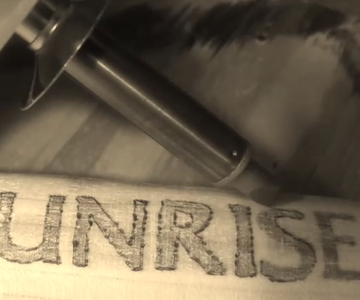

Step 2: Logo Time
After sanding it smooth and putting on some sort of finish, you can proceed to putting a logo on the barrel. The way I went about this was to print the logo that I wanted onto some of the backer paper that stickers come on. I'm not sure exactly what you call it, but you know the smooth, glossy paper that stickers come on that the stickers just come right off of. Well ink does the same thing.
IMPORTANT TIP:
I learned this the hard way, but you need to go into an image editing software and reverse the image before you print it, so it will apply the correct way.
Just print your image and place it on the bat. Be careful to put it straight on there, so you won't smudge the ink. Rub it on for just a few seconds, then you can pull it off.
Now that you have your image on the bat, you can use a woodburning iron to outline the letters and images however you see fit.
After you're done with that, it's up to you if you want to add some wax or lacquer or however you want the finished product to look.
