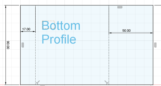

Step 1: Cutting Out the Frame
Cut out the cardboard parts according to the dimensions in the CAD images above. You can use a pen to mark the dimensions on a sheet and start cutting from there. In the side profile, the angled construction (broken) lines represent where you should cut. While in the bottom profile, they represent where you should fold the cardboard. You can use any hard edged object to make the folds(Note that the dimensions are not exact, so you have some wiggle room for adjustment).
Ensure that your bottom profile's height is at least 12cm wide to accommodate two 280 motors.
Afterwards, you can assemble the pieces with tape or hot glue like in the step below
Step 2: Assemble Frame
Here We need to glue or tape the peices together to make the chassis of the tank.
The shorter angled edge on the side profile should be oriented on the bottom.
The bottom profile should neatly fold around the two side profiles.
Pierce two holes in the side profiles using the 280 motors.
