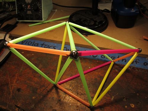

Step 1: Gather Materials
This Instructable requires:
* Magnetic space frame model - You can buy toy kits like Geomags consisting of plastic struts with magnets on their ends and steel spheres, or you can put together your own from drinking straws, magnets, and steel spheres you can buy for much cheaper.

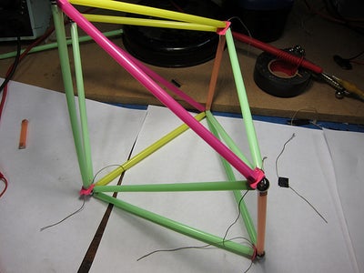

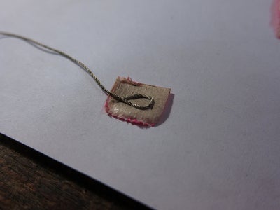

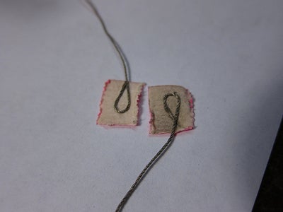

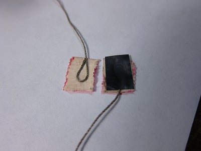

Step 2: Make Your Sensors
Follow the instructions from Plusea's Instructable to make the sticky tape pressure sensors. I didn't have conductive fabric, so mine don't have nice tabs like hers, but they still work fine.
I made mine very small and thin - this way they don't interfere too much with the magnets' attraction.

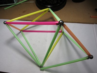

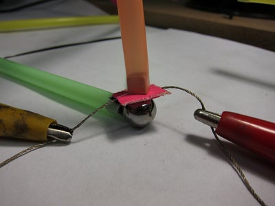

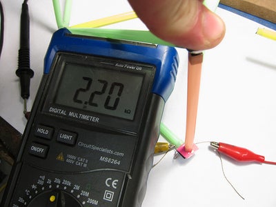

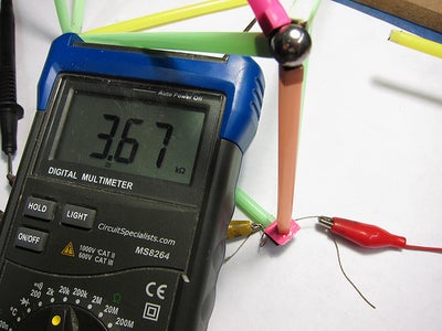

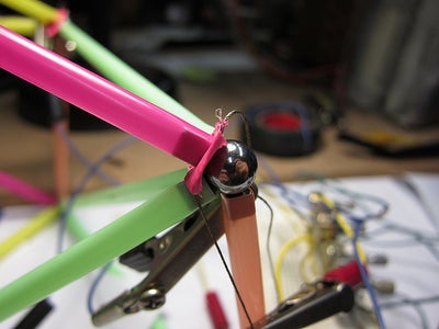

Step 3: Put the Sensors in the Model
The magnets should be strong enough to hold the thin sensor between the end of the strut and the steel hub. Just sandwich it in there like you see in the pictures. Sandwiches all around!
The force of the magnet will create some pressure on the sensor to begin with. Pushing on it (placing it in compression) will add more pressure to this. Pulling the node away from the strut (putting it in tension) will lower the pressure. More pressure will decrease the electrical resistance, less pressure will increase the resistance. You can check this with your multimeter by hooking the leads up to to the conductive threads coming out of the sensor.

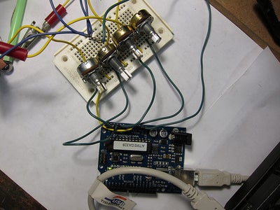

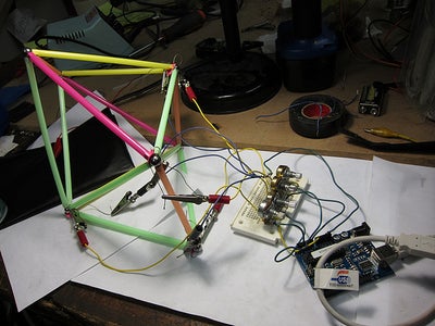

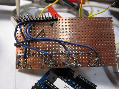

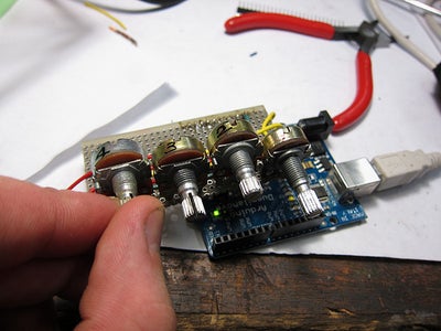

Step 4: Connect the Sensors to Your Arduino
I would make a very sad electrical engineer. See the second picture on this step for an example of my failures. But you are probably much smarter than I or have more determination or simply can learn from my mistakes.
Connecting the sensors into the Arduino might be straightforward for you. Or, if you're like me, it might seem like some electrical voodoo magick and you just follow blindly what others have done. In any case, it requires setting up a voltage divider for each of the inputs. This lets the Arduino interpret your changing resistance as a changing voltage.
I'm totally not qualified to explain this, but here's my attempt: Your sensors have two leads coming from them. One goes to the +5V on your Arduino. The other connects to the Analog Input pin on the Arduino, and also in series to a resistor connected to the GND pin on the Arduino. The value of this resistor depends on the range of resistances your sensor creates. Instead of experimenting by swapping in and out resistors (or calculating it the engineering way), I just put a potentiometer in series and adjusted it until I got a reasonable response.

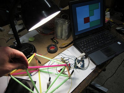

Step 5: Set Up the Programs
Plug the Arduino into your computer (a connection even I can handle!) and upload the code below labeled "ARDUINO". Open Processing and run the code below labeled "PROCESSING".

With the Processing code running, you should see four horizontal bars on your screen (it's hard coded to only handle four sensors; extending it for more or less is an exercise for the reader). Press the spacebar to set the zero-points (a one-point calibration!) and the bars should shrink to thin lines in the center of the screen.
Press on one of the nodes on your structure. You should see the width of the bars change. Green bars that extend to the right represent compression forces; red bars to the left represent tension forces. Try adjusting the resistor values/changing the potentiometers if you see a very small or too large of a response. You may need to press the space bar again to re-zero the sensors; they tend to drift quite a bit.
The software is doing a couple of things. First, it is averaging the past few readings to get rid of some noise. Second, it compares the averaged reading to the zero point you set, and determines if there is more or less force on the sensor. The size of the bar is only relative to itself; it's not calibrated to any unit of force. Maybe someone can figure out a way to do that. I'm not sure if the response from the sensors is linear, and that might be a problem.
