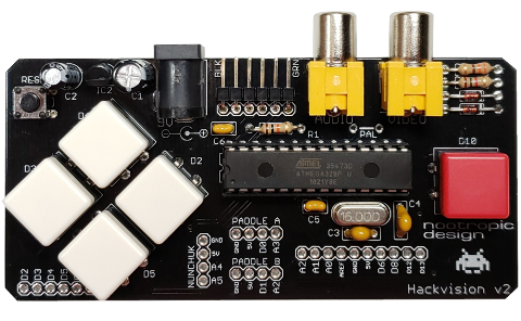

I went onto the Nootropic web page and ordered a Hackvision assembled(there is a kit version) preloaded with Star Wars and Pong(There is an option for Asteroids as well) shipping to the UK was reasonable and delivery time was good.
On opening the pcb, its well made and has a number of buttons so you can play this right out of the box.

This is the point where I never read the Instructions correctly, the Hackvision runs on 9v power, I ordered a power supply off Amazon not thinking about the polarity of the centre pin, the one I ordered had centre negative!! D'oh!
The Hackvision is centre positive as clearly stated, too late, I had already powered it up, I wasn't getting anything at all out of the Hackvision and I tried it on 2 TV's zilch nothing, that's when I decided to contact Nootropic design and it was deemed I could have damaged the voltage regulator and possibly the Microprocessor.
The gave me instructions on how to test, which was using a Multimeter across the 5v and Ground on one of the paddle controller pins, It should read 5v this wasn't the case so I had an issue, they very kindly gave me the part number and where its position was on the pcb so I ordered this part, they cost next to nothing and if it works it will be worth it.
I snipped the old regulator off as close to the pcb as I could and applied solder to the 3 pins, I don't have much luck with de soldering the pin holes, so I cut down the 3 legs on the regulator and soldered it into position, plugging the correct 9v supply in it worked, and further connections to the initial TV that I wanted to use were made(Connections are Video and Audio) I had to buy the correct RCA cables) RCA to HDMI didn't work for me so it was the Yellow for Video and White for audio cable, its mono so the red cable is unused, I had to use a Scart RCA adapter as well.

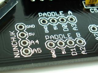

Nootropics have very cleverly added some pins onto the pcb so paddle controllers can be used for the pong game with 1 or 2 persons, this works with a 10K potentiometer and a Momentary button switch and also they have pins for a controller for the Space Invaders game, which in my case is just going to be Momentary buttons, 2 for left and right, another for firing and the 4th is to reset the program which takes you back to the menu, the fire button also selects the program, there are 2 more buttons on the PCB these are to toggle between Space Invaders or Pong and also for the letters if you want to add names to the scores, they are also up and down for the paddles in Pong.

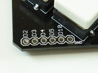

On the PCB I am going to solder the controller wires straight onto the pins as this will be a permanent feature of the coffee table, I used the angled pins for this and this is for playing Space Invaders, the cable I'm using is an old Ethernet cable, this cable has 4 pairs.
There is a reset button on the PCB, I shorted the pins on this to find out which pins I needed to solder the cables to to mirror this reset button on the controller.
The next job was to solder cables onto the pins needed for Ground and the 2 buttons for left right and the firing button, these will be mirrored onto the controller, D2 Left D3 Right, D10 is the firing button and GND I also soldered the cables onto D4 up and D5

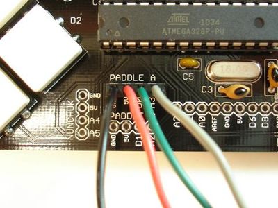

On the pcb there are pins for paddle control, Paddle A and Paddle B I will be using the same enclosures for these 2 controllers.
This next segment is copied and pasted from the Nootropic web site, you can use whichever colour cable you want as long as the pins correspond.
Solder wires to your button and potentiometer. The potentiometer has a connection to ground (black wire), 5V (red wire), and a connection for the analog voltage output (gray wire). The middle contact of the potentiometer is called the “wiper” and it is connected to the grey wire which will be used to read the position of the pot. Note which contacts that the ground and 5V wires are connected to — use the same connections as seen in this bottom view. The button has two contacts: one for the digital input (green), and one for ground. In this picture, I connected the ground wire to the ground connections on the potentiometers.
