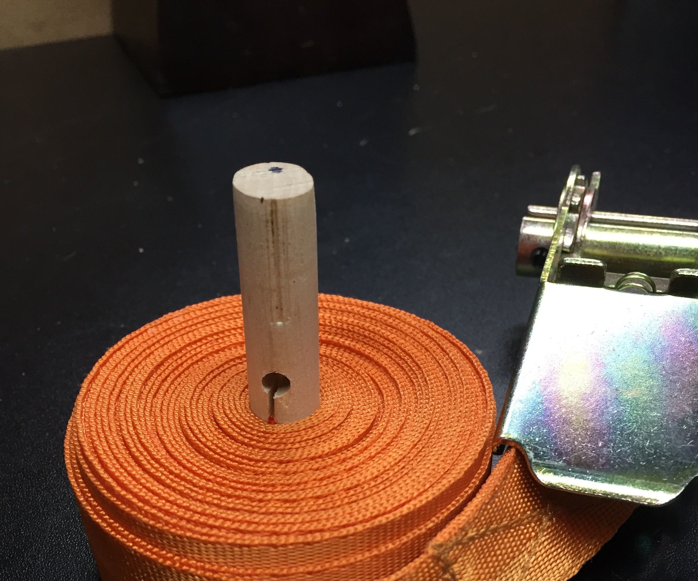

The first thing to do is fit the short dowels in place in outside edge of the side pieces. To do this, put the dowels in the holes and hold each piece in place where they will hang, and tap the dowel from the inside until it is as far as it will fit into the mounting hole. Mark a line on each dowel. Then take the dowel out, apply glue, and re-insert the dowel up to the line. Rotate slightly until the glue catches. (I wasn't worried about the glue squeezing out, as this would be hidden when the rack is mounted.
Next, put a healthy dab of glue in each hole. I find that wiping the dab from the bottle on the edge of the hole ensures glue will apply to the sides of the hole, rather than just goop up on the bottom (which might also create an air bubble that could prevent the dowel from entering all the way). Put all the dowel rods into place, and use large clamps to squeeze the two side pieces together. It's important to not squeeze one clamp too much before putting the other clamp on, but rather to tighten each clamp gradually and evenly, or the pieces might bind. Let is sit according to your glue's instructions.
