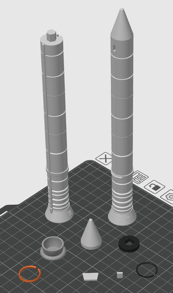

Step 5: Slice Kit Full-Booster (FB) for SRB
Slice for the Full-Booster Kit.
For Solid Rocket Booster there are specific settings for speed and temperature only for "SRB_Jonction_Top/Bot" but you can try with normal settings first.
Same as last step for supports are required for "SRB_Tank" they are in green on the slicer pictures.
A "Raft" or "Help Disk" on the "SRB_Circle" if you can't print them without one.

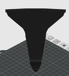

Step 6: Slice Orbiter (O)
For the Orbiter there are specific speed and temperature settings only for the "O_Nose_Grey" and "O_Wing_L/R_Grey", but you can try the normal settings first.
Supports are not required for any part but can help for "O_AFT_White" and "O_Wing_L/R_Grey" as shown in green in the image above.
Raft and Brim can help in case of poor grip on small parts like "Windows" or "Wing".

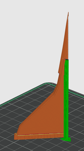

Step 7: Slice Kit Cut-Fuselage for Orbiter
Slice for the Cut-Fuselage Kit.
There are specific speed and temperature settings for the "O_Elevon", but you can try the normal settings first.
Supports are required for some parts, as shown in green in the image above.
You can use "Raft" or "Brim" for "O_Elevon_Black".
Step 8: Slice Kit Fuselage for Orbiter
Slice for the Fuselage Kit.
Supports are required for the "O_Fuselage" as shown in green in the image above.

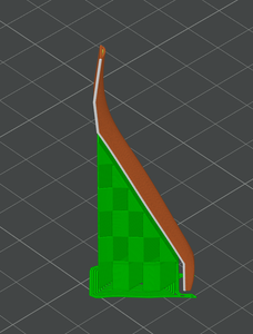

Step 9: Slice Kit Full-Fuselage for Orbiter
Slice for the Full-Fuselage Kit.
Supports are required for the "O_Full_Fuselage" as shown in green in the image above.
