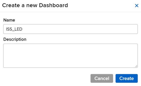

2. Click on Dashboards from the top bar and select New dashboard. Give the same name as your feed.

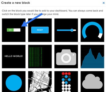

3. Click on the dashboard you created and select the gear icon on the right. Then select “Create a new block” and select the toggle switch.
4. Now select your feed name (ISS_LED in this case) in the popup window.

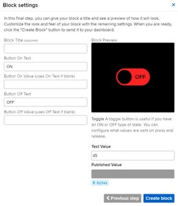

Then click on the next step. In the next window, don’t change anything. Just click “create block

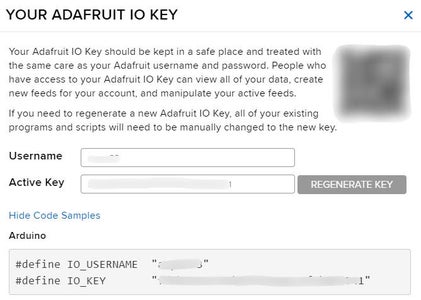

5 .Now your block is created. Click on “My key” on the top bar and note down your username and active key. This is unique to your project and make sure not to share it with anyone (Unless you want them to mess with your project that is)

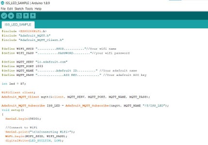

Make sure you have the Nodemcu and adafruit mqtt libraries installed on your arduino IDE.
There are a few changes you need to do in order to get the code working.
1. Replace …….SSID……. with your WiFi (or mobile hotspot) name.
2. Replace ………PASSWORD……. with your WiFi (or mobile hotspot) password.
3. Replace …………Adafruit ID.............. with your Adafruit username
4. Replace …………AIO key............. with the active key you had noted after creating the Adafruit toggle switch
If you have named your Adafruit feed as ISS_LED then you are done with editing the code. But if you have used a different name, you’ll have to replace all the instances of ISS_LED in the code with the name you have used.
This code keeps the LED turned OFF by default. When the ISS arrives, it starts blinking. In case you want the LED to be ON by default, you can replace digitalWrite(led,LOW); with digitalWrite(led,HIGH); in the first line of the void loop() function.
Great job! Now you can go ahead and upload the code to your Nodemcu.
