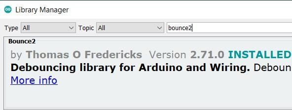

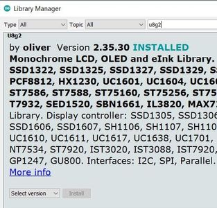

For the project to work, you need to have U8g2 library and Bounce2 library installed. To get this library, you can search directly from Tools -> Manage Libraries.

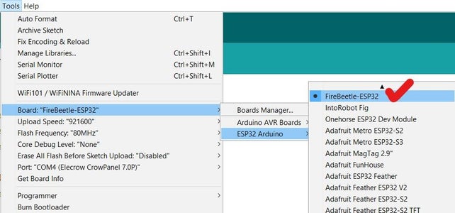

Since I am using DFrobot Firebeetle ESP32, I chose this module form Tools -> Board. If you are using other ESP32 module, you are suggested to select the right module from the list. After everything is done, just upload the code and enjoy.

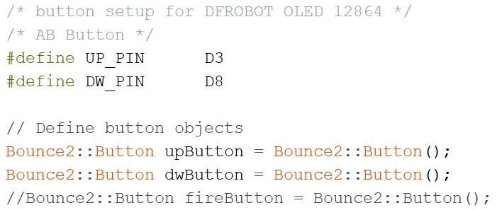

Alright, I know you are lazy but please also spend some time reading this paragraph. Since I am using the OLED Module from DFrobot, the button is occupying pin D3 and D8. In case you want to use your own ESP32 module with other button setups, you need to modify the code (see the image). And finally, congratulations, hope you can get your own ESP32 game console! Feel free to share your thoughts in the comment section.
