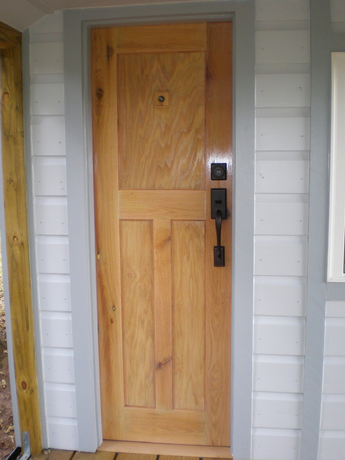

This is a door I designed and built for my tinyhouse on wheels but, it could be applied to any inside door!
Step 1: Building the Main Door Frame.
The door frame is pretty simple to build with the proper tools. Unfortunately, I didn't take many pictures of this step. So to explain the picture I can tell you that this is the type of joint I used in all 4 corners. This door frame was built on the cheap so the only wood that was used were common 2x4s and 2x6s. My door is very small width and height wise so this step is just to show the basics. Normally a panel door is built with 2 or more panels for strength and decoration but, for this build I decided to use one solid panel so the interior of the closet section would be more accommodating. I ran planed down 2x6s and 2x4s (no specific dimensions) on a table saw with a dado blade set to 1/2". This could be done with a 1/4" blade with mutiple passes or an 1/8" blade for that matter. Anyway, the frame itself is just 2 horizontals tongue and grooved between 2 vertical rails. If you look at the picture the groove in the edge is offset............. that is purposely done to give more hollow space for use in the closet! That extra 3/4" for me was the difference between staying within the door jam or bulging into the bathroom! The way I set the saw is to cut the groove 1/4" from the side that is to be the outside of the board. Once the boards are grooved, you can cut the 2 vertical boards to length. Next, I oversize cut the horizontals so the tongues could be cut on each end. Now, a 1/2" piece of plywood can be cut to fill the space in the frame. If your still reading you probably have some wood working experience and can now glue and clamp everything together.

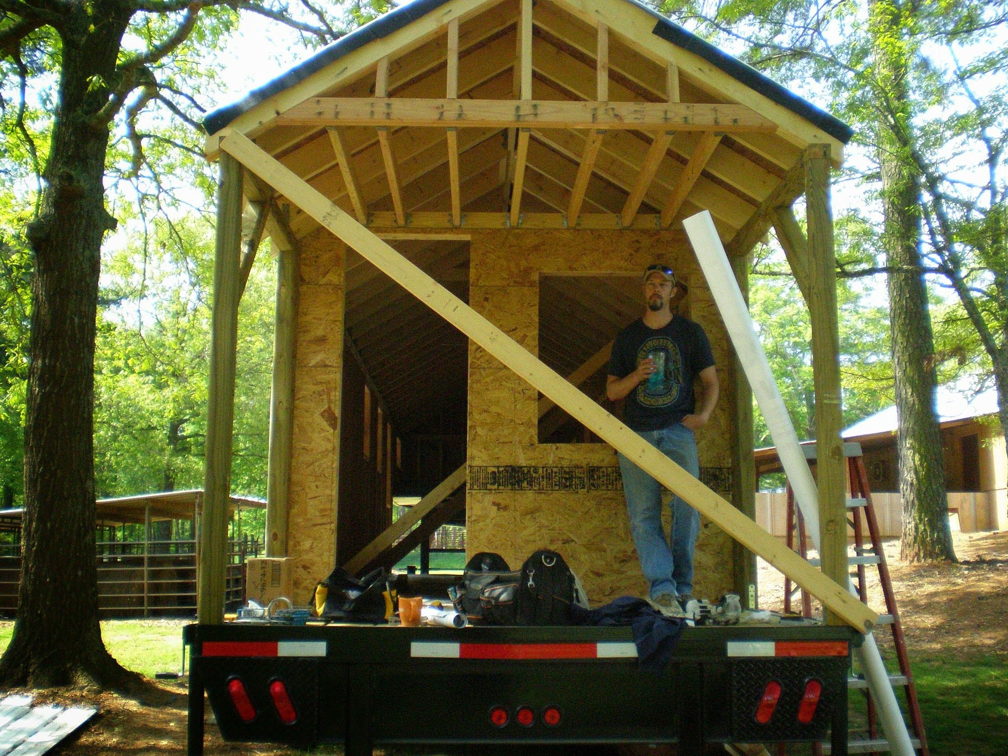

I am currently building a tinyhouse on wheels. So, only having 16 sq ft for a bathroom I had to come up with ways to have extra storage. This one thing has given us all the space we need and it only used the space of the wall width! If you would like to see more of our tiny house visit [atinyhomecompanion.blogspot.com]. All of the work is done outside, without a shop, and just basic hand and power tools. Oh yeah, this is my first ible!
