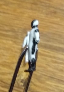

Step 2: Figures Wearing SpaceX's Spacesuits
You can find the 3D model here:
https://www.myminifactory.com/object/3d-print-spac...
I printed the model lying on its side, with supports, using a .4mm nozzle and .12mm resolution. Printing it this way means that the arms don't have very good definition, but I think they turned out okay. Again, paint with nail polish.
