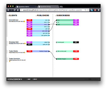

Spacebrew is an amazing tool for connecting devices, programs and interactions quickly and easily. With it you don't need any knowledge of web technologies to be able to prototype projects that communicate via the internet.
In order to take the tricky html/css/javascript coding out of the web side of things, Spacebrew consists of a series of libraries for Arduino, Processing, Javascript (for browser based interactions) and OpenFrameworks. We recommend you take a look at Brett and Julio's Getting Started Guide.
Essentially, whenever a Spacebrew example is run (processing, javascript, etc.), a "publisher" or "subscriber" is created on the Spacebrew server. The official documentation has examples of how to run your own server, but there is also a public server available for use immediately.
Publishers
A "publisher" is basically something sending out some form of data. These will show up on the left column of the server.
Subscribers
Subscribers show up on the right column of the server and will receive information that is sent to them.
Connections
The most fun and easy part! The browser based graphical interface allows you to literally make connections between publishers and subscribers by clicking on the nodes as seen in the photo above. It really is that easy.
Data Types
The type of data that can be sent. This must be the same on both the publisher and subscriber side in order for a connection to be made. Booleans, intergers from 0-1023, and strings of text are supported immediately with the option to create custom data types for slightly more advanced users).

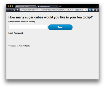

Will use a modified version of the "Javascript String Sender" example. The modifications made to it only serve to make the on screen text a little more relevant, but the straight-up, off the shelf string example would work just fine.
This javascript example (can be run locally on your own browser by clicking the "index.html" file or can be made live on the web by uploading it to your own server) will be a publisher and will connect to the processing example that will appear in the subscriber list. The processing sketch will then send data to the arduino via the serial cable.

Once the processing sketch and javascript app is running you can see it show up in the spacebrew public server. Once you see them, just click the publisher part of the "teabot mobile" (the name given to the javascript app) and connect it to the subscriber part of the "teabot controller" (the name given to the processing sketch).
Once this connection is made the two are ready to send data to each other! Thats it, no web skills needed!
