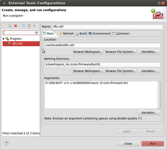

Set up dfu-util
- Select Run > External Tools > External Tools Configurations… and create a new configuration to execute the dfu-util command to upload your firmware with a mouse click. (See the last picture.)
- Arguments:
-d 1d50:607f -a 0 -s 0x08005000:leave -D core-firmware.bin

Step 13: Using External Flash
Spark Core has 0x180000 bytes (~1.5MB) of free storage in external flash. This can be very useful for storing all kinds of resources.
For example, to upload a 2K binary file into external flash:
dfu-util -d 1d50:607f -a 1 -s 0x80000:2048 -D upload.bin
To download 2K of external flash data into a file:
dfu-util -d 1d50:607f -a 1 -s 0x80000:2048 -U download.bin
You must always write even number of bytes!
To read the stored data from code on the Core:
uint16_t currentSeedIndex; sFLASH_ReadBuffer((uint8_t*)¤tSeedIndex, CURRENT_SEED_INDEX_ADDRESS, sizeof(currentSeedIndex));
To write stored data:
sFLASH_EraseSector(CURRENT_SEED_INDEX_ADDRESS); sFLASH_WriteBuffer((uint8_t*)¤tSeedIndex, CURRENT_SEED_INDEX_ADDRESS, sizeof(currentSeedIndex));
I am not sure why, but in some cases you may have to erase a sector before writing to it. The size of the erasable sectors is 4kB = 0x1000. So e.g., if you erase the sector at 0x80000, that erases everything from 0x80000 to 0x80FFF. The next sector begins at 0x81000.
Step 14: Uploading Pre-Computed Seeds
There is a small utility program provided for just this purpose. You can find it in RandomNumberGenerator/src/RandomNumberGenerator.cpp. Run this program and it will generate a file called seeds.bin. The contents of this file will need to be stored in the External Flash on the Core.
Storing The Seeds in External Flash
Upload the firmware to the Spark Core like so:
$ dfu-util -d 1d50:607f -a 1 -s 0x80000:393218 -D seeds.bin
393218 is the size of the seeds.bin file. (65536 keys * 6 bytes each)
