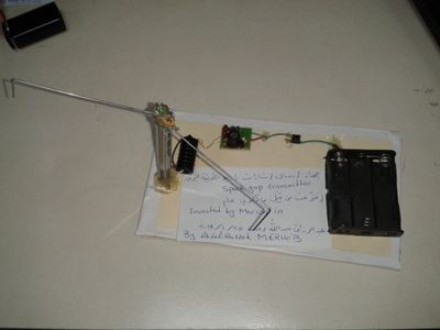

I made the transmitter using the electronics of an electric lighter. This lighter uses the 1.5v of an AA battery to produce sparks that start fire. The electronics of the lighter (actually it is an oscillator) transforms the 1.5 DCV into alternating voltage, then the HV transformer increases the amplitude of the alternating voltage to kilovolt values. The very high amplitude signal breaks the isolation of the air gap producing sparks. The spark gap and the antenna are made of segments of steel ropes.
Another alternative for an easy and simple transmitter is the use of piezo electric spark generator of a lighter.

NOTE: to broadcast using different channels, one has to add an LC Band Pass Filter (BPF) that indicates the channel frequency to both the transmitter and the receiver. The channel frequency is equal to the natural frequency (or resonance frequency) of the LC filter: f = 1/(2*pi*sqrt(L*C)). Note that receiving the signal requires that the receiver is tuned on the same channel (it uses the same LC BPF).

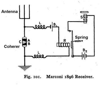

It is not until Marconi that electromagnetic signals became transmitting useful messages safely. Marconi uses a coherer which is a device invented by the French physicist Edouard Branly that is able to detect electric signals. From wikipedia, a coherer is a " device consisting of a tube or capsule containing two electrodes spaced a small distance apart with loose metal filings in the space between. When a radio frequency signal is applied to the device, the metal particles would cling together or "cohere", reducing the initial high resistance of the device, thereby allowing a much greater direct current to flow through it".

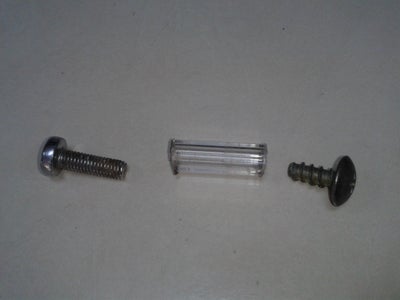

I made my own coherer using a plastic tube (sometimes made of an old pen), iron filing collected from a neighbor blacksmith, and some nails and screws as cathodes. I made some examples with different distances between the cathodes, and after some experiments I ended up using the best working coherer. The coherer is placed in series with a 9v battery, an ON/OFF switch, and an LED. n antenna is also connected to one end of the coherer. Make sure that you connected the LED in the right direction, else it will never go on.

Before you start "playing" with the transceiver, make sure that the iron filling between the coherer cathodes is not too squeezed between the screws. Note that the resistance of the iron filling decreases when the iron particles are squeezed, which allows great current to flow across the circuit burning out your LED. You might add a resistance (1K for example) in series with the coherer to ensure that the total resistance of the circuit will not decreases to dangerous values.
Turn ON the transmitter and the receiver circuits. If the LED is ON initially, tap gently on the coherer with your finger until the LED goes OFF. Place the transmitter and the receiver several steps away, and press the button on the transmitter; you should see and hear the sparks across the transmitter gap. If the receiver is in range, the LED turns ON indicating that an RF signal is received. Try to move the receiver closer to the transmitter if the LED stays OFF. Note that the LED remains ON after the reception of the first message, and you have to reset it by tapping again gently with your finger. On the Marconi receiver, the inventor uses an electric bell to indicate the reception of the signal, and another electric bell apparatus to shake the coherer and reset it (the second bell has no cone). Your receiver is now ready to receive the next message.
