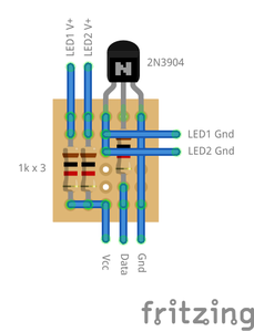

Step 7: Install the LED Eyes
Our Wall-e already came with some LED eyes, so we will reuse these and give them a blink effect a little later on in code. For now we need to connect them up to power and our MCU so we will tackle this now.
Not knowing the exact spec of the LED's and knowing the spark core is only 3.3v, I decided to wire the LED's directly to the power supply, and use an NPN transistor to do the flicking on and off. This way it puts less demand on the MCU.
Route the eye wires
To start with, we'll route the wires from the right eye, over to the left eye housing (we are going to put a tiny circuit inside there so we need to bring all the wires together). The right eye should have a green, purple and black wire. You should have previously cut the black wire earlier on. The black wire should be wired up to the same pin as the purple wire. As we only need one wire per pin, just remove the black wire completely.
If you've remove the LED housings from the eyes in an earlier step, go ahead and put the right eye LED housing back into place, not forgetting to put the eye lense back first. Route the wire through the hole in the eye back, and fix the eye back back into place. Leaving plenty of length, twist the purple and green LED's together, and pass them through the eye back of the left eye.
Put the left eye into place inside the eye housing. Make sure you have some wire connected to each leg (these only need to be short). If you left enough attached from earlier, you should have one with a black wire, and one with a blue wire.
Create the switching board (See fritzing diagram)
Using a small piece of perfboard, construct the following circuit and attach the wires from the eyes accordingly. If your eye wiring is the same, which it should be, the black and purple wires should be + and the green and blue wires should be -.
Next, cut approx 5 inches of servo wire and pass it through the left eye back (you may need to make an additional hole), soldering one end to the switch board in the appropriate place as per the above schematic.
With the switching board complete, place it in the left eye housing to one side, and close the housing up. You should now have a pear of wires coming from the right eye to left, and 5 inches of servo wire coming out of the left eye.
