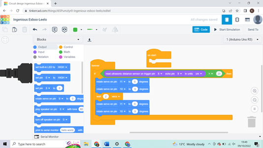

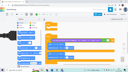

I designed the circuit for the SparkBots, and all of the introductory circuits, using Tinkercad. As someone who isn't amazing at programming, it was a great way to make sure all of my code actually worked properly, and it was also very easy to understand for the students. The circuit diagrams are really clear and you can run simulations to demonstrate how the circuit works.

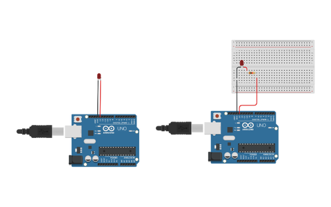

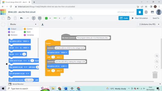

We preloaded the code to the boards (although if you are using completely fresh Arduinos they often come with the blink LED circuit already uploaded). The Blink LED circuit is considered the 'Hello World' of Arduino, and Tinkercad has a standard circuit and code available to select.
The students seemed to really enjoy jumping straight in to getting a circuit to work, simply plugging the LED straight into the Arduino. We then moved to using a breadboard, making sure to pass round a breadboard with the back peeled so they could properly understand how it worked. Some of the students really grasped this quickly and we got them working on how to introduce a switch in, while others needed a bit more time to play around with the original circuit.
Quite a few of the LEDs got blown! It was a useful demonstration of some of the basic principles of electronics (power, voltage, current etc) that we had tried to explain, and the smell of burning plastic was a powerful reminder of what they had learned. Also explanations of polarity of LEDs got a lot of nods of understanding after they had struggled with putting them in the wrong way round and nothing working.

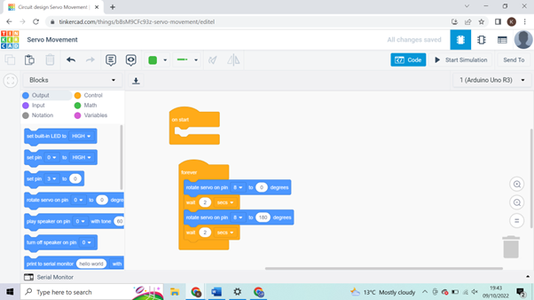

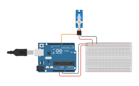

This was the activity that probably went the most smoothly! In their break time I went around and uploaded more code to the boards. The only issues that students had with this one was getting their power and ground the wrong way round, which was a theme that continued throughout the day (after debugging a lot of circuits you learn to check they've got this right first!).
We also had to remind them to unplug their batteries as the micro servos draw quite a lot of current so drain them fast (and had lots of spares on hand for when they inevitably forgot).

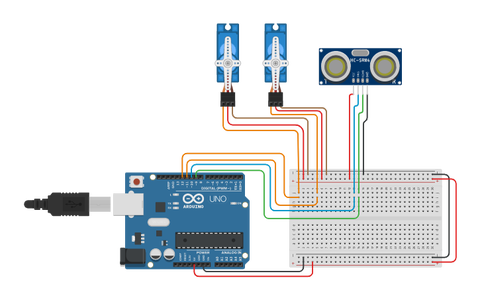

Step 6: Activity 3: Ultrasonic Sensor Circuits

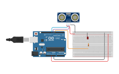

The students seemed confused about the concept of male to male vs female to male wires (and there were quite a few sniggers, understandably - they are 13 year olds). But other than that this circuit also went pretty well, and it was their first one using multiple components working together.
We also gave a brief overview of the principles of sound waves, including watching an interesting video about how some blind people employ echolocation to try and work out where they are going.

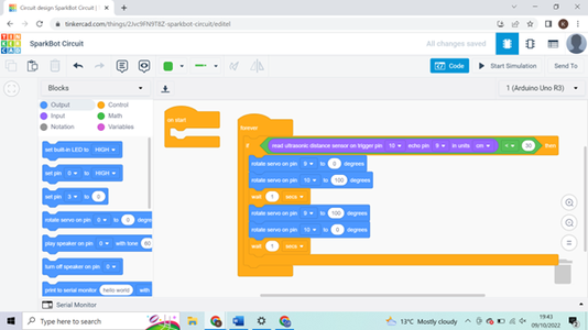

Step 8: Coding SparkBots
At this stage some students came up with quite elaborate ideas, and if I did it again I would gently discourage them from the more extreme ends of this as they just don't have the time. However it was an interesting exercise for a lot of them as they attempted coding the robots, and found it quite a bit more difficult than they were expecting - probably because our main focus of the day was hardware.
If you were doing this activity as part of a weekly club you would definitely want to spend a bit more time teaching them about coding. The Tinkercad interface works really well, especially if you have students who are just outgrowing languages like Scratch but don't yet have the confidence to write fully in C++ themselves. You can write code in the block based language in Tinkercad and then see how it translates to C++ - we encouraged students to point out differences they noticed between them and they picked up on lots of things that I didn't even notice!

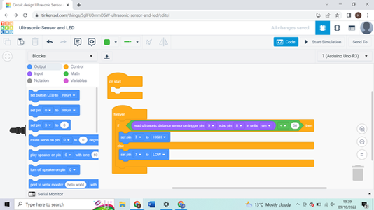

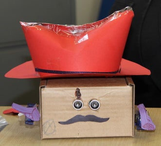

There were so many awesome ideas, and all but 2 groups managed to make a finished robot. We had a cowboy, the Duolingo owl, and even a small car which was very impressive given the equipment that they were given. One particularly impressive group wrote their own code to integrate an LED into the process, which they had light up when the sensor detected movement - they showed a really good understanding of the principles they had learned.
