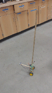

Step 3: Build

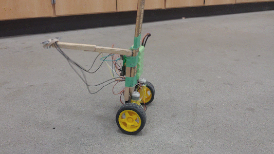

Follow the instructions for Circuit 5c for the most part. The proximity sensor will need to be mounted on a stick like shown in the picture and its associated wires will need to be connected to it (I soldered mine). In the code you will need to input some dimensions of this mount.
The meter stick (or equivalent object) should be mounted vertically, and as rigidly as possible.

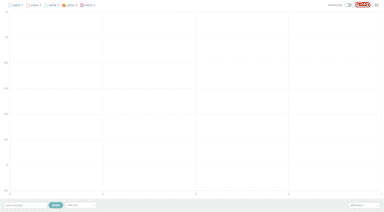

GIF 1 Shows the power given to the motors (Orange), and the changing setpoint angle (Purple).
GIF 2-3 Shows the components of the original PID.
