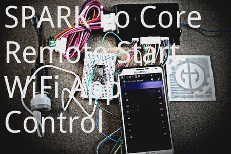

Let's add Wi-Fi to my existing remote start without needing to know any code!
This took 20 minutes to install.
You can pick up a simple system for $40-50 on Amazon (Avital 4103LX Remote Start System with Two 4-Button Remote )
On almost every aftermarket remote starter there are two wires which can integrate with a Spark I.O: Remote Start Activation (-) input and Remote Start Status (-) output.
We are going to show you how to use one of the GPIO pins to send ground to the activation wire and remote start your car over WiFi or the web.

In the main remote start harness there is a sequence activation wire (White with Blue on mine, but check your manual to verify)
Tie this wire to GPIO D1 pin on the Core
Add a diode with the white line facing towards the Spark Core. When the Core is in standby, it will rest on HIGH which is putting a 3.3v(+) output on this wire. This is acceptable, but to avoid any short circuit, this needs to be diode-isolated.
In the secondary Remote Starter plug there is a status wire (green, but still verify)
Tie this wire to the GPIO D2 pin on the Core.
That is all you need for version one which activates your RS unit with the Tinker app.
Step 3: Spark Io Code and Control
Remote Start with Tinker App
Open the Tinker app and tap the GPIO D1 pin to low which grounds the connection, then turn it to rest on HIGH after 1 second.
When the Remote Starter unit sees a ground (-) on the input wire, it will activate the remote start sequence and run for 12, 24, or 60 minutes depending on programming.
