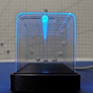

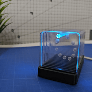

Perception of time is really an amazing and fascinating topic. Often we see analog clocks and get a feeling "Are we stuck in a loop going round and round"?, though in reality time is flowing continuously.
Inspired from this, I thought of making a simple desktop clock to visualize the flow of time in spatial dimensions from analog round dial clock.
From front view we can witness an analog round dial clock, from side view a linear clock, isometric view would visual spiral flow in 3D.

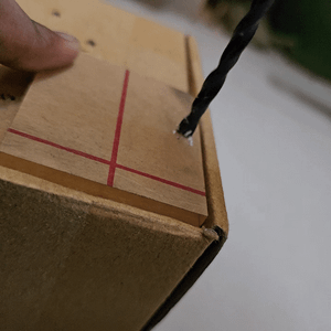

Step 4: Acrylic Parts - 3
  • With drilling machine, loaded with M5 drill bit
  • Drill a blind hole up to 4mm approx. on transparent slide
  • Similar procedure is followed for all the 12 transparent slides

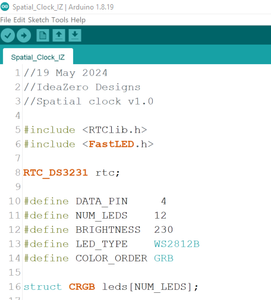

Step 10: Main Code
  • Upload the main code "Spatial_Clock_IZ.ino"
  • If DS3231 is used, time has to be set for first time
  • Firstly upload the code by uncommenting the update time line
  • rtc.adjust(DateTime(F(__DATE__), F(__TIME__)));
  • Then comment the same line and re-upload the code to set the time

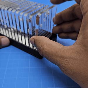

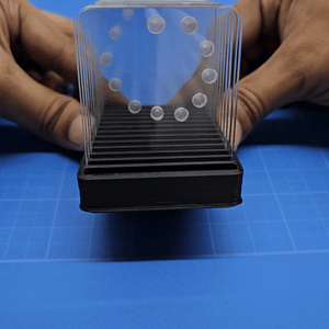

Step 11: Install Slides
  • Install the transparent slides,
  • First one is fully transparent for visual window
  • From second, slides are inserted in slots of the base in sequence with drill hole - counter clockwise from first hole

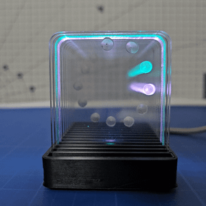

Step 12: Working Description
  • 12 hour clock format
  • Hour is represented by 2 colors
  • PM: Orange
  • AM: White
  • Minutes is represented by Green color
  • Seconds is represented by blinking the Green color in minutes slide (Blink rate ON=1 second; OFF 1 second)
  • Minutes is incremented every 5 minutes from one slide to another similar to analog minute clock hand (60 minutes / 12 = 5)
  • For every 1-hour there would be a blue color sweep across 12 slides to indicate the hour transition

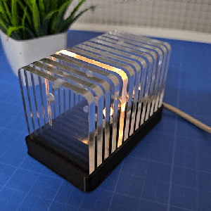

Step 13: Perspective
From front view we can witness an analog round dial clock, from side view a linear clock, isometric view would make a sine wave in 3D.
Step 14: In Action
