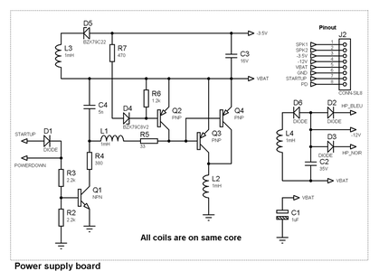

Step 2: Schematic
This schematic drawn by Furrtek** is for a different revision of the power board but it's close enough to understand how this simple switch mode power supply works.
There are two sections which were relevant to this repair.
  1. The Q3 and Q4 BJT PNP transistors are connected in parallel***. These will be the same type perhaps matched to some degree. These share the load when switching the coil L2 on.
  2. The STARTUP and (inverted) POWERDOWN lines start the power supply and keep it on, respectively, via the Q1 BJT NPN transistor****.
The photograph with just the top of the power board is the one that matches the schematic. The other photograph which has a flipped photograph of the underside alongside it is the one inside this Speak & Spell.
** D5 might be a normal diode rather than a zener.
*** This is also fairly obvious from a glance at the PCB traces.
**** This is discussed in more detail in the comments.

One of the PNP transistors from the pair was cracked presumably from excessive heat caused either by current significantly beyond the maximum value or by its partner failing leaving it with a doubled current. The non-cracked one was also replaced as it was likely to either be broken or stressed by high currents. Two 2N2907 transistors were used to replace these.
Step 4: Almost Working
After the replacement of the PNP transistor pair the Speak & Spell did not work on batteries (4 C cells with a recommendation for alkalines) but did work when powered by an external power supply. The external power supply set to 6V produced 6.4V DC possibly with some ripple. This was problematic as even fresh alkaline batteries only produce about 1.55V unloaded making 6.2V for the four batteries. Alkaline batteries decrease in voltage as they are used - the device also needs to be able to turn up with used batteries which still have some remaining charge.
Step 5: Soft Power on Circuit
With the Speak & Spell powered at 6.00V by an external power supply attached to the battery terminals the STARTUP line was checked with a multimeter by holding down the ON button. This action only raised it to 1.8V. The D1 diode drop reduces this to 1.2V and the potential divider reduces this further to 0.6V. This is going to be very close the Vbe of a (silicon bipolar) transistor and was the likely explanation for why the power supply did not turn on using battery power as it needed a slightly higher supply voltage.
The Falstad circuit simulation above with a lamp standing in the for the rest of the circuit shows this scenario. The push button raises the STARTUP voltage to 1.8V which isn't enough to turn on the transistor. The POWERDOWN line can easily turn on the transistor - a manual switch represents the microprocessor here. The 400 ohm resistor is a guess at the microprocessor's output pin impedance, the 13.5k resistor was chosen to represent this particular membrane keyboard based on the 1.8V measured value.
