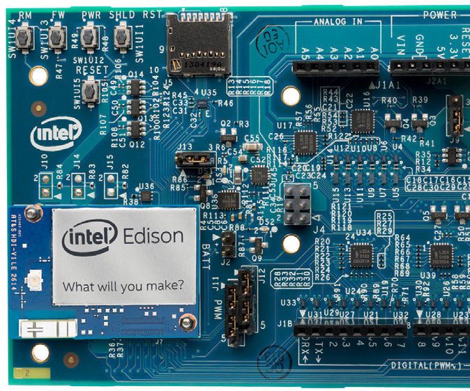

Internet is filled with all kinds of useful information. We are going to build a gadget in this Instructuble using Intel Edison that you can easily use to gather the information and speak out the information using TTS (text to speech synthesis software).
The information available on Internet is aggregated into what is known as RSS feed which stands for Rich Site Summary/Really simple syndication.
This web technology is used to update frequently changing information such as News, Stock price, weather etc... Let's say you need to know the stock price of a corporation. There are plenty of web services that update this particular information and each service provider assigns an unique address for the stock price of your favorite corporation when you access this address, as a response you get the current stock price (with some added meta data). For user input, we are going to use an infrared proximity sensor such as this one to detect the user action and to determine what information the user wants from the Internet.

Step 2: Making Hardware Connections
For this step, you'll need following things
  1. Grove Kit base shield
  2. Grove kit LCD
  3. Grove kit LED (optional)
  4. Grove kit temperature
  5. sensor IR proximity sensor
Make the following connections:
  • LCD - I2C0
  • LED-D4
  • Temperature sensor-A1
  • IR proximity sensor
    • Vcc/5v to 5V on Edison(via base shield) header
    • Gnd to any of the GND on Galileo header
    • Output to D7 on Edison(via base shield) header
To connect any USB device, to the USB host port of the base board, you'll need to move the switch near the USB port towards the USB host port as in the attached picture. In this mode, you will have to power the base board with a DC power supply adapter (7V-15V, I used the power adapter that came with Intel Galileo Gen2) .
You can connect the USB audio card directly to the Edison USB port but I recommend using an externally powered USB hub to connect the audio card for better performance.
