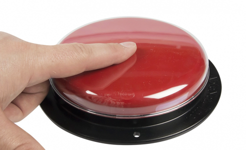

AbleNet Big Red Switch (or similar device)

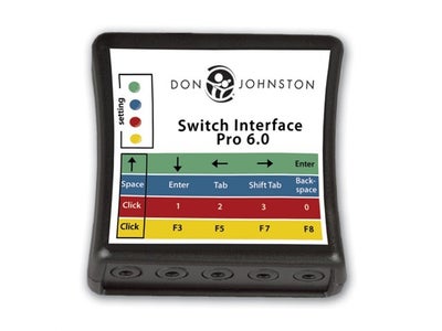

Don Johnston Switch Interface Pro (or similar device)

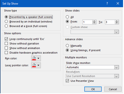

Step 3: Configure Slide Show
We need to set up the slide show to only include our first half and to loop automatically when it ends.
  1. At the top of the PowerPoint window select the "Slide Show" tab.
  2. Click on "Set Up Slide Show"
  3. Check the box "Loop continuously until Esc"
  4. Change the slide range from "All" to only the first half of your slides
  5. Enter slideshow presentation mode and confirm only the first half of your slides appear.

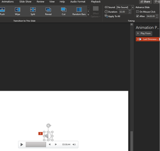

Step 4: Set Up Timings
Timings are necessary to make the slides transition automatically between options or after media is complete. How long to set timings is up to your discretion. This tutorial example uses 5 seconds for option slides and a few seconds longer than a video/song's length for media slides.
  1. Starting with the first media slide, select the "Transitions" tab at the top of the PowerPoint window.
  2. Under "Advance Slide" at the top right, uncheck "On Mouse Click" and check "After:"
  3. Enter the time in the box next to after: (my song is 3min 58seconds so I enter 4:00.00)
    • Time format used by PowerPoint is HH:MM:SS.MS
    • A timing less than the media's length will not work as intended.
      • If your timing is too short, the slide will simply transition after the media completes.
  4. Repeat for all media slides.
  5. Start a presentation and confirm after media completes, slide show returns to the first half of your slides
Step 5: Configure Switch & Interface
The switch interface converts the button press into a computer input (mouse click or keyboard key) through USB.
  1. Connect Big Red Button to a switch interface port that has "click" as an option.
  2. Plug switch interface into a USB port on your computer.
  3. Press the button on the switch interface until the "setting" light matches the row with "click" for the port connected to the Big Red Button.
  4. Test if the Big Red Button works the same as a mouse click

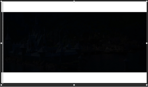

Step 6: Protect Media During Playback
A common issue that could occur is accidental activation of the Big Red Button which pauses a video or song. To resume the media would require another click. To prevent this from occurring, a workaround must be used as there is no option built into PowerPoint to stop clicks from pausing media. If this behavior is desirable to you, this step can be skipped.
  1. On each slide with media, insert a text box using the "Insert" tab followed by selecting "Text Box"
  2. Draw the textbox to the full width of the PowerPoint slide.
  3. Type in the text box using the "Enter" key until the textbox is larger than the slide vertically
  4. In the image included with this step, you can see the highlighted vertical bar shows all the enters i pressed.
  5. Start a slideshow presentation and confirm clicking no longer pauses media.
