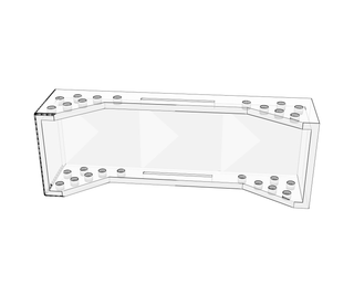

Step 4: Battery Holder Design
This battery holder is going to be placed on the upper plate of the frame and hold the master switch. I designed in autocad 123d. Turnigy hard case lipo fits perfectly but zop 4s 5000 lipo fits vertical. Bases of the holder and the battery are covered with a velcro. I preassebled the battery holder to check the measurements were correct.
