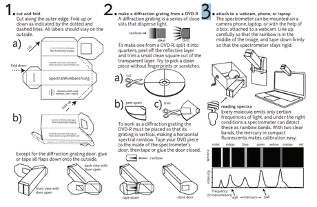

Step 1: Read and Comprehend the Instructions
Before starting this DYI (do it yourself) experiment you need to read this concrete directions that will help us later to build our spectrograph.

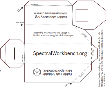

Step 2: Build the Spectograph
After reading the instructions from the last step, these are all the materials you need to build the spectrograph, in my case, I recommend using a black cardboard (as the one shown in the photo), and an only side cd for it to much easier to manage for the lens of your product.
