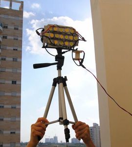

Dimming and changing the color spectrum of LED's? IMPOSSIBLE! Nope... Now Not!
As this is my 50th Instructable, I've decided to upload a super "special edition" Instructable:
How To Make Your Own INSANELY Bright 200 WATT Variable Spectrum LED Panel- For under $25!
I decided to call it "SpectrumLED"
I will use SpectrumLED for many different purposes such as: Photography Light (for filming my 'Ibles), Reading Light for Books (in my bed), Extra Lighting for My Projects (on my table) And a lot More!
Did you know that The light output of SpectrumLED is equivalent to a ~2,000 Watt Incandescent Bulb!?!
This means that SpectrumLED will give about 50 times more light than an average incandescent light bulb that you have in your room*, while only consuming about 5 times more power at full brightness!
But, What does "Variable Spectrum" mean?
If you look closely at the picture above, You might be able to see that some of the LED's look white, And some look yellow.
Each color (white or yellow) is controlled by a separate dimmer, This means that I can choose any color that ranges between white-ish blue-ish -and- yellow-ish orange-ish. That is A LOT of different colors.

Here comes the hardest part: Start soldering the LED's...
As you can see in picture #1, I cut some wire to a short length (~7 cm / ~2.75 inch), And started soldering each column in parallel (-to-, +to+), It is very important to first solder only the LED's in each column in parallel. If you solder all of the LED's in together parallel, They won't work well because the wire can't deliver enough current, And it's way to hard to solder thick wires to the LED's. This might remind you somehow of putting jumper wires on a bread-board
Obviously, To let the dimmers control the different colors of the LED's, You have to solder cool-white and warm-white separately...
After soldering ALL of the cool LED's columns, I soldered all of the columns together in parallel (Picture #2)
Now repeat everything you did with the Warm-White LED's, Do your best not to die of boredom ;), Because it takes a very long time!
After you're done with both, Check for continuity between the LED's, They should all be "Continuit-ized", Or if I explain it a bit better: Each different polarity of the LED's should be "continuit-ized" with all of the other same colored LED's
Make sure that none of the LED's touch the heat-sink, Do this with your multi-meter too

    Were these dimmers able to handle all those many LEDs? What are they rated at?
    BTW your each new instructable is better than older one. Keep it up!
    0
    Yonatan24
    Yonatan24
    Reply 5 years ago
    Nope. I mean yes. Kind of.
    I think they were rated for either 5 or 8 amps - the one that powered the cool white LED's got really hot, and the one that powered the warm white LED's stayed pretty cool. But I don't recommend these since they flicker pretty badly. I recommend the dimmers that I used for SpectrumLED V2.0, they do get quite hot when I power the lamps at full power, which isn't something I do very often anyway. Issues solved:
