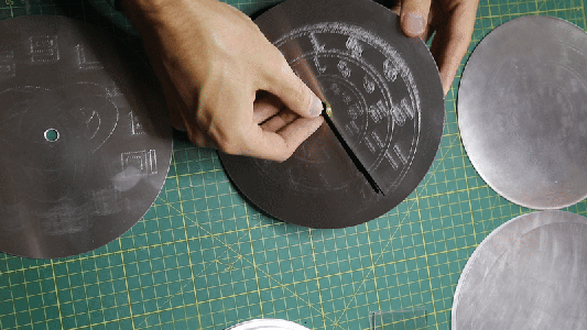

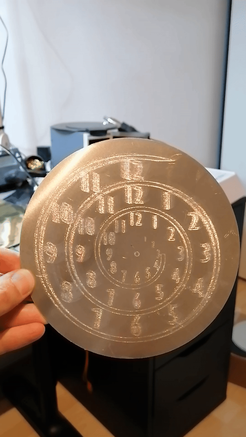

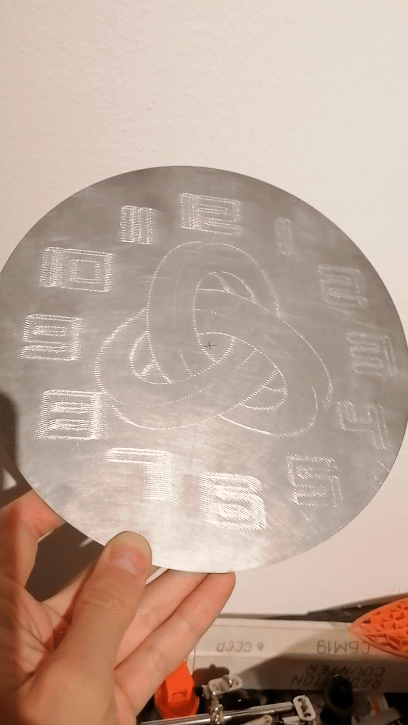

In the process of making these myself I went through a bunch of literature and instructional videos, tried out various softwares, codes, materials and fabrication methods before finally arriving at the shown specular holograms. These were created on aluminum plates with a modified 3D printer and used to make a pretty wall clock.
Unfortunately, the 3D nature of the holograms cannot be conveyed by the pictures above.

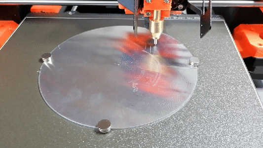

In the end, I decided to convert my Prusa MK4S 3D printer into an engraving machine. At first, I tried my punch tool for engraving which generally worked but later I bought a spring loaded engraving bit which had a much smaller tip. I also replaced the spring of the engraving bit with a much softer spring from a ballpoint pen. To mount the engraving bit, I removed the print and hotend fan and fixed the engraver into a 3D printed holder that attaches onto the extruder.

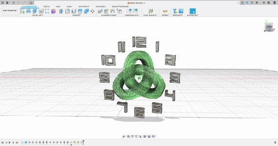

At first, I designed two different clockfaces in Fusion360. The first consist of a trefoil knot in the center and three dimensional numbers placed around. The second design features a spiral that was adapted from my polarizer clock. The designs were then exported as a stl files. When exporting it is important to choose a low detail setting in order to reduce the number of facets.

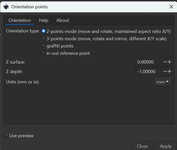

- go to "extensions->gcodetools->orientation points", set "z depth: -1.0" and hit "apply"

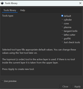

- go to "extensions->gcodetools->tools library", choose "tools type: default" and hit "apply"
- use the text tool to change the following settings in the green box
- diameter: 0.1
- feed: 2400
- penetration feed: 720
- passing feed: 18000

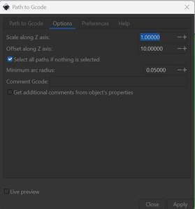

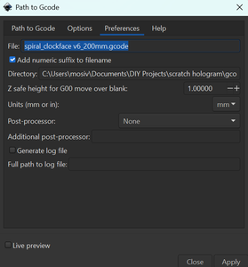

- go to "extensions->gcodetools->path to gcode" and enter the following settings in the tabs:
- cutting order: pass by pass
- offset along Z axis: 10.0
- Z safe height: 1.0
- File: "desired output filename"
- Directory: choose the directory where the "header" and "footer" files are located
- go back to the "path to gcode" tab and hit "apply"

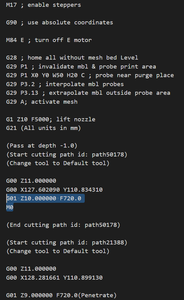

- open the generated gcode file in an editor
- insert the lines "G01 Z10.000000 F720.0" and "M0" into the first cutting path (i.e. the triangle) after the gcode command that moves to the start position of the path ("G0 Z11, G0 X... Y..."), see screenshot above. The "M0" parameter inserts a pause in order to mount the engraving tool and place the workpiece.
- delete the rest of the first cutting path (see screenshot) so that the triangle will not be engraved into the workpiece
- save the modified gcode file

Before engraving I marked the center position of the workpiece and removed the engraving bit from my 3D printer. After uploading the gcode file and starting the "print" it first completes the mesh bed levelling and then moves to the center postion (the one that was marked with the triangle in the svg file). The engraving bit is then mounted onto the extruder and the workpiece is aligned below. The height of the engraving bit is adjusted by hand so that it just touches the workpiece. In the gcode the bit will move 1mm down from this position when engraving and 1mm up inbetween. Finally, the workpiece is fixed with magnets. I used the textured steel sheet underneath the workpiece to increase friction. Be sure to have enough clearance for the magnets otherwise your workpiece may slide away and you start to engrave the steel sheet. The force during engraving can be optimized using the grub screw on top of the negraving bit that pushes onto the spring.

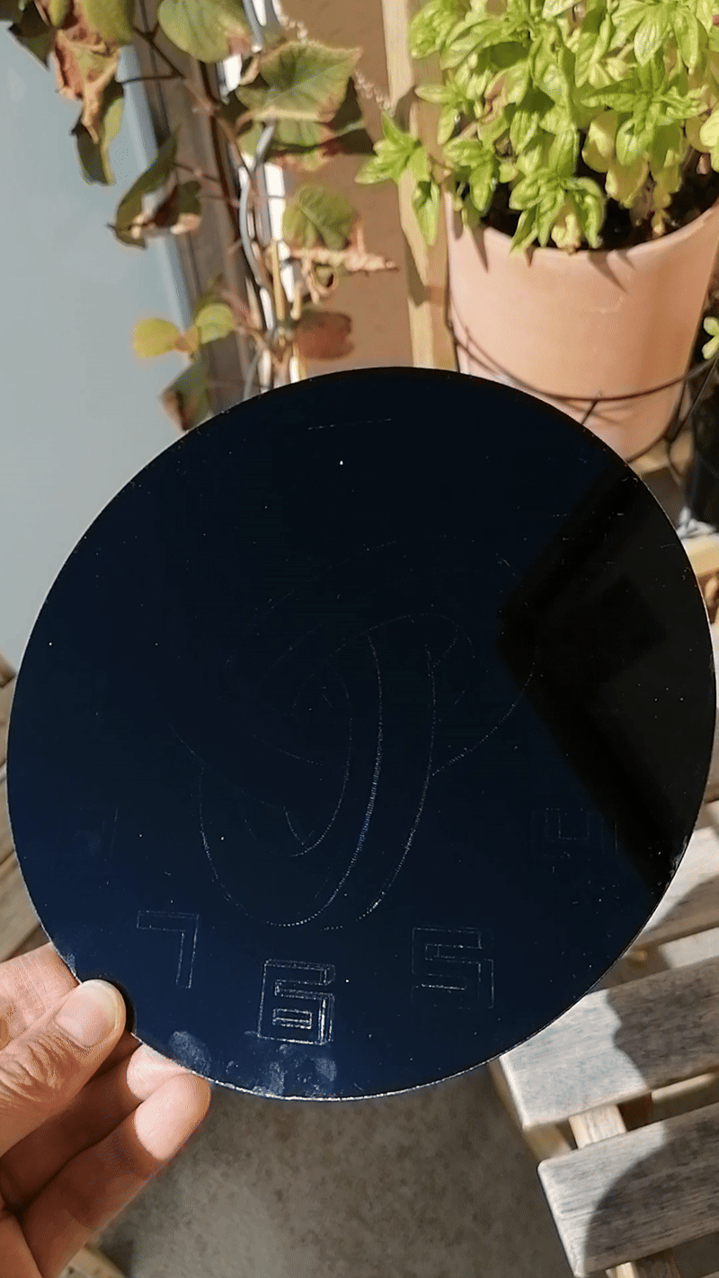

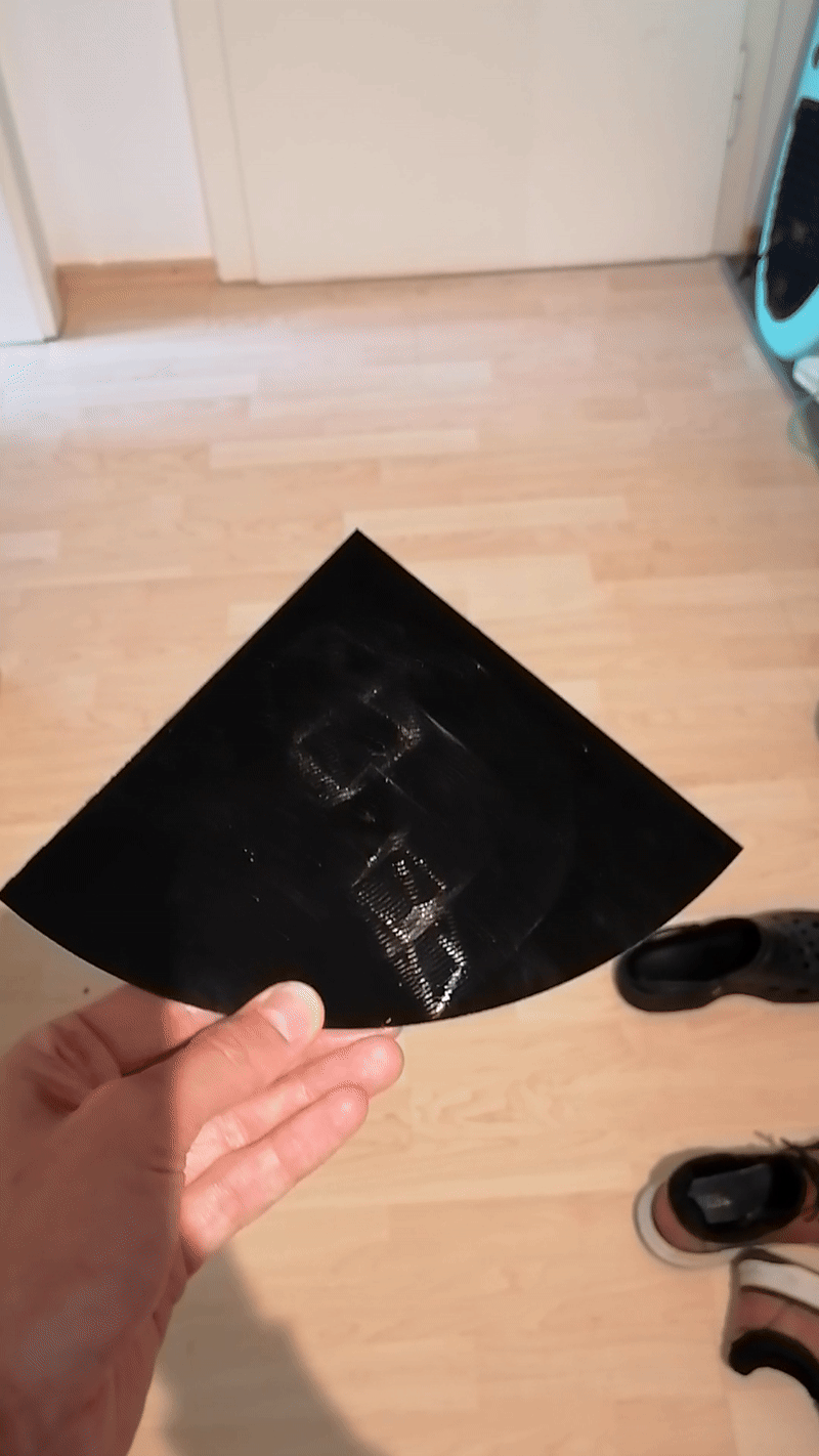

I tried to engrave aluminum and black acrylic. Engraving acrylic is more delicate because if the force of the engraving bit is too large you do not produce glints but deep scratches that appear white. Also the hologram is less bright than those produced on aluminum.
Buffing the surface of the aluminum with very fine 3000 grit sand paper reduced the interfering glare from the specular surface but also decreased the brightness of the hologram.

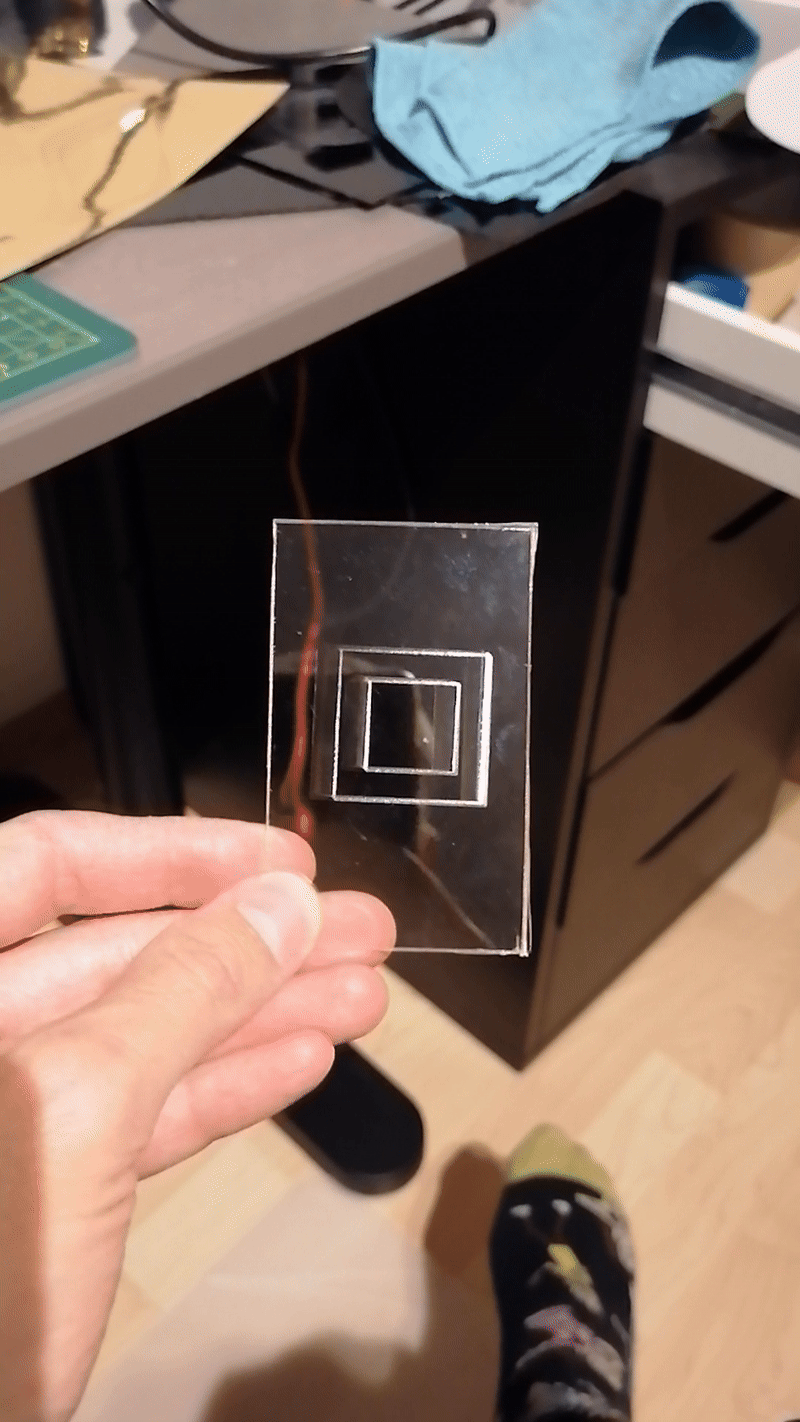

I also engraved some transparent plastic pieces I had lying around which worked rather well. I used these to experiment with kind of nixie tube like assembly but then abandoned this idea again.
