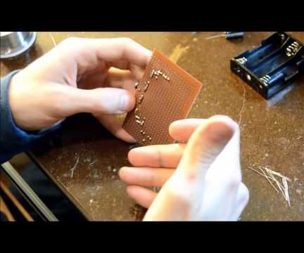

Step 3: Video for Proof of Concept
"This is my 'I'm proud of what I've done' face"
The potentiometer connected to the PT2399 adjusts the delay amount, and the potentiometer closest to the LM386 adjusts the volume output to the headset. The video shows just how well it works, even when pretty poorly tuned!
