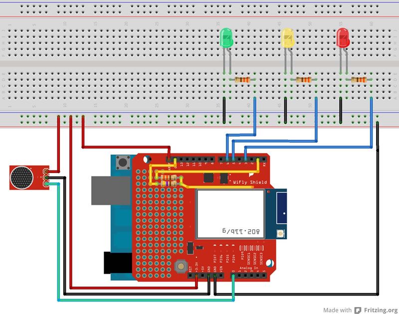

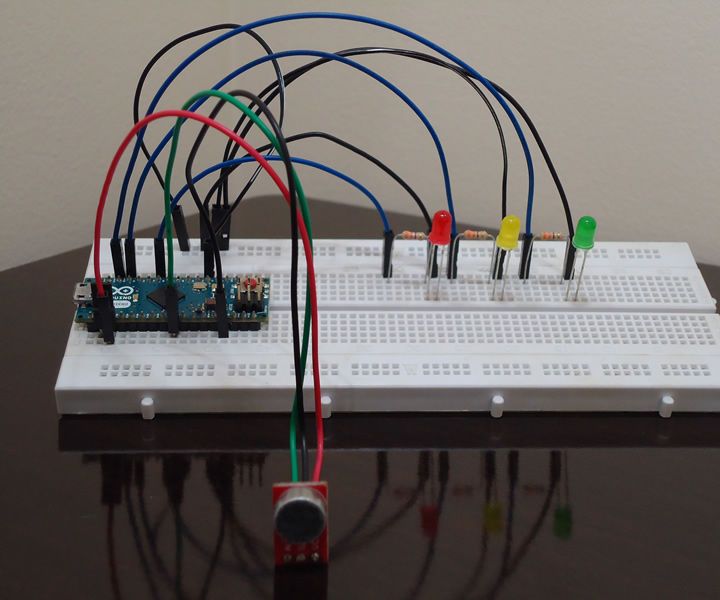

Step 1: Wiring
The first step is to wire the Arduino and the breadboard with the components as shown in the pictures above. I had to place a small rubber underneath the speaker because it vibrates a lot and without the rubber the quality of the audio is considerably affected.
Here we have a small but important difference from my previous Instructable. Most Arduino boards run at 5V, but the DUE runs at 3.3V. Because I got better results running the Sparkfun Electret Breakout at 3.3V, I recommend you add a jumper between the 3.3V pin and the AREF pin IF you are using 5V Arduino boards. The DUE already uses a 3.3V analog reference so you do not need a jumper to the AREF pin. In fact, the AREF pin on the DUE is connected to the microcontroller through a resistor bridge. To use the AREF pin, resistor BR1 must be desoldered from the PCB.
