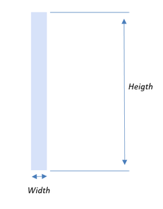

The canvas being 1920x1080 (cf. Step 4.3 Define size of Canvas), to draw a centered rectangle, it is needed to move to the coordinates (1920/2 ; 1080) and to rotate grid by 180° in order to draw rectangle from bottom to top.
void draw() {
//Re-initialize Grid (clear previous drawing)
  background(0);
 float Width=15;   //Define width in pixels
 float Height=100; //Define height in pixels
 float Xpos=0;     //Define X1
 float Ypos=100;   //Define Y1
 float Angle=0;    //Define Angle for initial iteration
// Move grid to plot location
 translate(1920/2, 1080);
 rotate(radians(180));
// Draw Rectangle
 rect(0,0,Width,Height);
To best understand transformation (rotate, translate, ...), do not hesitate to have a look to Processing documentation (https://processing.org/tutorials/transform2d)
By running the code, you should be able to hear the recorded sound (loop) and to see one centered rectangle in middle of the canvas (nothing fancy yet).

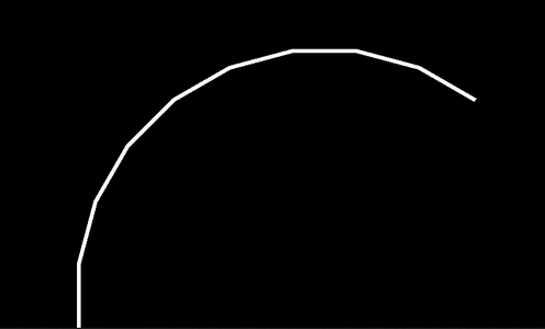

Choose a ChildAngle relative to Angle for every next iterations:
ChildAngle = Angle + 15 ;
Up to this point, the result might be disappointing. The recursion being defined only with an increasing Angle (+15° each iteration), this ends up with only one series of branches bent at a rate of 15° per branch.
Solution consists in defining the recursion twice, once with an increasing angle, another with a decreasing angle :
