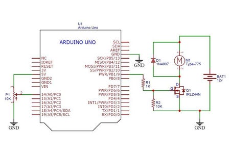

Step 1: Circuit Diagram of Speed Control of DC Motor Using MOSFET
Here's the simple circuit diagram for controlling a DC motor's speed using an Arduino and a MOSFET. This minimal-component design is easy to understand. For direction control, check out our L293D project.
Circuit Diagram Overview:
  • Components: Arduino UNO, MOSFET, 1k Ohm resistor, 10k Ohm potentiometer, diode, 12V power supply.
  • Connections:
  • MOSFET connects the Arduino to the motor, acting as a driver.
  • The 9th pin of the Arduino (PWM capable) controls the MOSFET.
  • The potentiometer connects to 5V, ground, and A0 for variable voltage input.
  • A diode protects against reverse EMF from the motor.

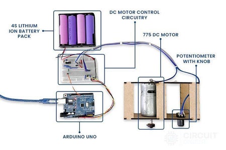

Step 2: Component Assembly of Speed Control of DC Motor Using MOSFET
We used a breadboard to assemble the simple circuit, a power bank for the Arduino UNO, and a 4S Li-ion battery pack for the motor. The connections follow the previously discussed diagram.
Ensure the breadboard is in good condition to avoid connection issues.
