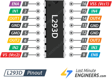

1.8 Air Pump and Air Valve
The Air Pump and Air Valve require 12V, while the Arduino Board only takes 5V. Therefore, you'll need to separate the circuit into two by using a motor driver IC 'L293D'.
If you do not have access to the L293D motor driver IC, you can choose to use a MOSFET transistor as a substitute. However, it's important to take necessary precautions and include a 'flyback' diode when controlling a motor using the transistor.

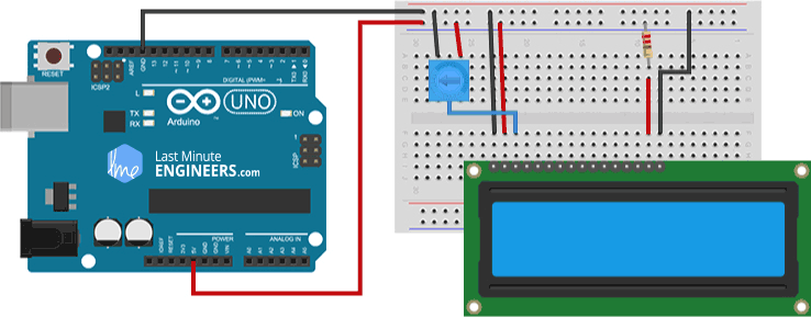

1.9 LCD Display
Finally, the 16x2 LCD Display is a fun feature that lets you customize texts and create a timer for your speed date. You can also design items for each cell on the display, enhancing the overall user experience.
Although, it's important to note that you will need multiple jumper wires to connect the components, along with a potentiometer to modify the background brightness.

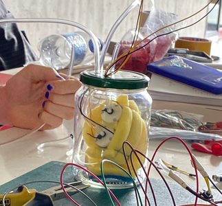

Step 2: Sound Insulation
2.1 Materials
Empty Jar of Cucumbers
Hand Towel
Elastic Band
2.2 Equipment
Hot Glue Gun
Cutter
2.3 Instruction
This step explains how to isolate the air pumps, so their noise doesn’t interfere with the sound sensor.
You’ll need the two fully connected air pumps with wires for electricity and tubes for air, isolation material such as fabric-scraps or a sponge, an old towel in which to wrap the jar, some rubber bands and an empty jar with a screwed-on plastic or metal lid that is large enough to accommodate all these things.
Connect the tubing and the wiring to the air pumps. Fit the two pumps between a couple of pieces of sponge or fabric. Make sure the tubes are not overly bended, so the air can flow easily. Fixate the isolation to the pumps using the rubber bands and make sure that the pumps cannot touch the jar directly. Poke five holes into the lid, two for each pump and one for the wires. Fit the four tubes and the wires through the holes and use glue to fill any gaps. Finally wrap the jar in a thick towel, so it cannot touch the box directly.
